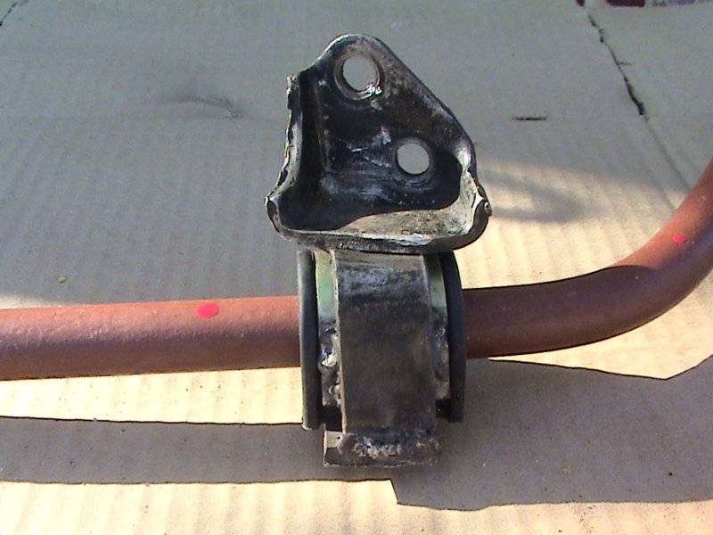

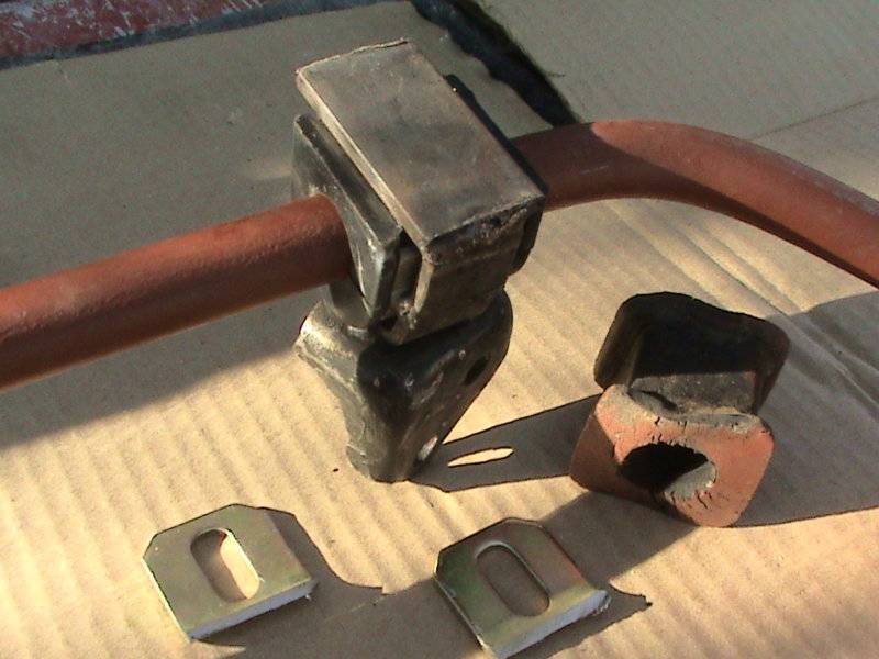

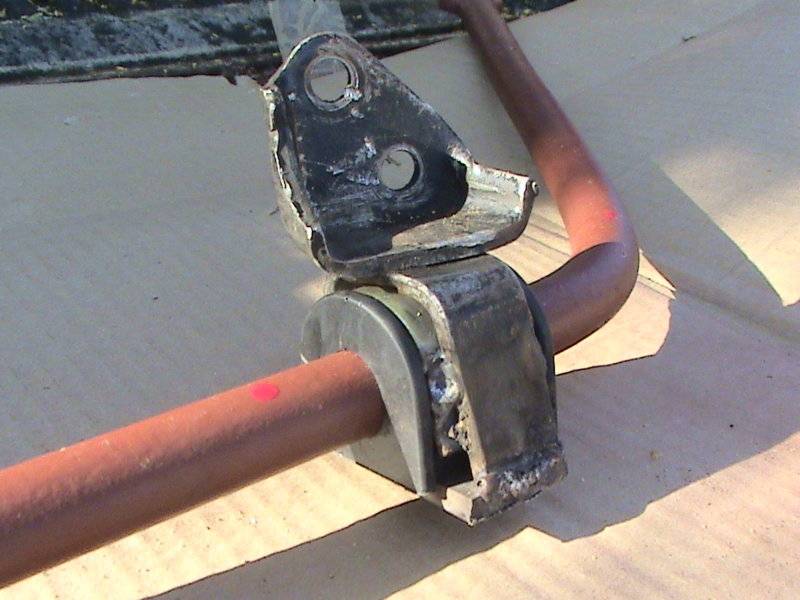

I couldn't find correct bushings for my '65 Barracuda Formula "S", but found some generics that do the job perfectly-not what you want, I know, but sometimes we have to make do.
View attachment 753793 View attachment 753794 View attachment 753795
I know what you're saying. Yes I'd like to find something original but I know the originals are dried up and the aftermarket isn't the best with some parts. The MOOG on the car now are modified so they work. I guess I may have to live with them. I looked in the Factory Parts Manual, there isn't even a parts number listed for the B or E body.
If I remember correctly, on my A body the bushing exterior was metal and welded to the bar, almost as if they were not even designed to be replaced.

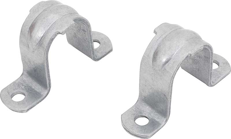

Yes, the Moog rubber versions are not correct. Poly versions of that bushing with the correct location are fairly common, rubber OE type not so much. If you find it, let me know. What angle do you describe? The polys do fit mine just fine, are you sure your brackets aren't bent?
https://www.suspension.com/5.5113
I suppose they could be bent. I assumed since both brackets have the same angle to them that's the way they were meant to be.
Have yet to come across an original bracket that had not been knocked rearward by contact with a high curb or something. Pretty easy to straighten them out.
