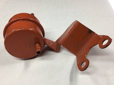

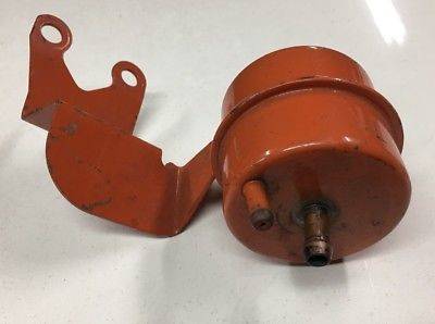

:xscuseless: This is from a 71 charger. I'm pretty sure it was a 440 car. Does it look correct? -Tom

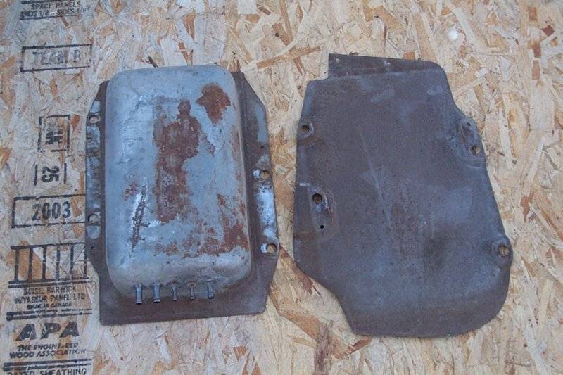

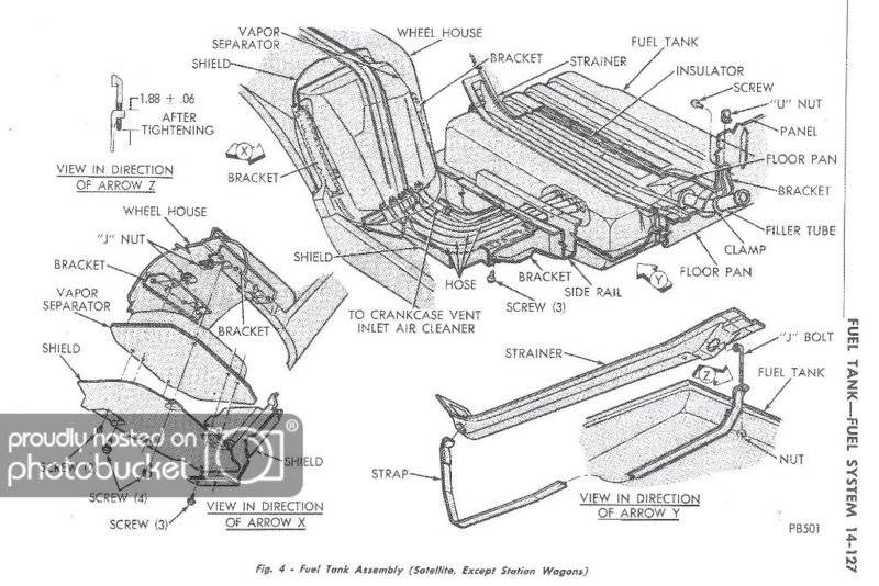

Sorry Tom, mine is on a Satellite, but 71 Charger were the same. Mine is in the wheelwell in the rear drivers side and hides behind a panel(on the right in the pic). It is a large box with 5 lines going to it(on the left)...
Thanks.
No to hard to grab a 72 block that's right above the tank they didn't rot away like the 71 cars did I've seen many 71's sporting the 72 vent system
That is the vapor separator not the canister. That’s gonna be tough to find. If I were in your shoes and it’s just pinholes, I would double coat it in flex seal and be done with it.

Vapor separator, thats what I need...
I actually considered smearing JB putty over the pinholes & spraying the entire tank with bedliner...
I actually have a seperator from a 73' I could hide up in there behind the shield/cover... Hmmm... Never considered it...
the last spare one I have from a 71 satty has some pits but no holes
it was rust treated and sprayed in grey to protect it
