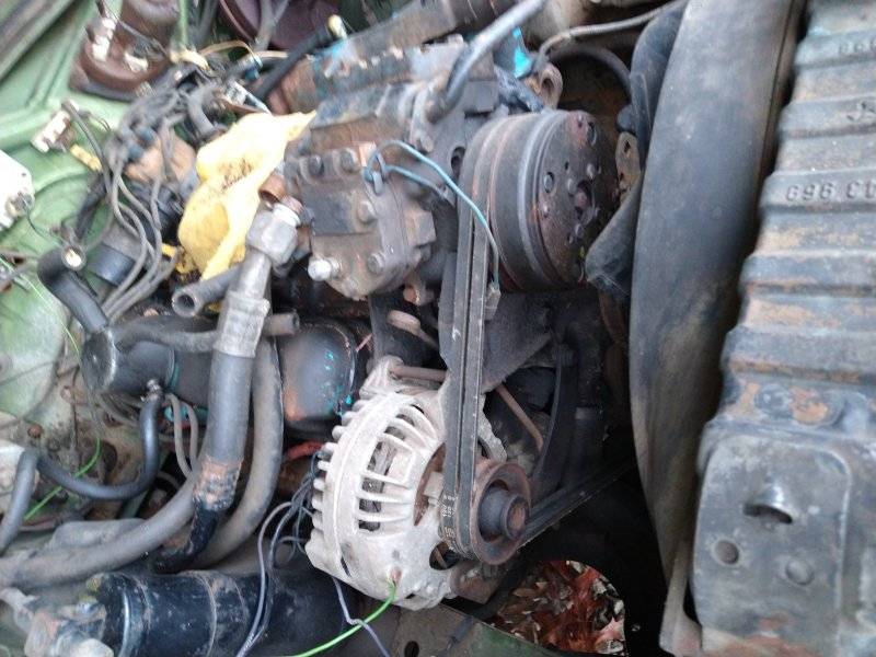

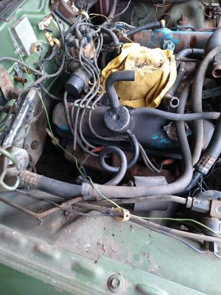

It has been a year or two since my first post, (in summary I am a 14 year old trying to get a low mileage 71 satellite 318 running after it sat for 20 years). Feel free to look at that one on my profile for more info. I am trying to figure out where to start on it now. I will try again but so far the crankshaft hasn't turned (I am pulling from the base of the radiator fan). Does that mean that the engine would have to be swapped?

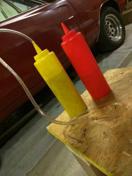

I basically squirt a solid shot glass worth of 10W30 in each cylinder (a good 1.5 ounces or half+ of a bathroom dixie cup) and then let it sit for 24 hours. I used a bottle from a dollar store (yellow bottle has oil, red has gas) that I filled with oil and squeezed on about 18" or so of fish tank air tubing so that I could feed the end into each cylinder and squirt in some oil. I also pulled the valve covers and drizzled some oil on the rockers and on the push rods and valve springs/valves. After 24 or so hours, I cranked it by hand on the crank pulley bolt. Once it turns, with the valve covers off, you can also make sure all of the valves are moving up and down and you should be able to spin each pushrod around at some point in the engine cranking when the rocker arm isn't pushing on it.
You'll probably need to remove the fan shroud and possibly the fan if you still need more room for the breaker bar/rachet.

And yeah. Right in the spark plug hole like an inch or two. If you don't use a tube it'll be quite messy tipping the bottle mostly upside down. With a tube you can just tilt it a little and squeeze. That's kinda why WD40 is used a bit because it's easy to get in the spark plug hole but a little hard to judge how much is going in and it's quite thin. A lot will run right past the rings. With oil, it will get spread around as you turn the engine by hand at a breakneck 1/10rpm. Maybe I'm wrong, but I think the point of the WD40 way is if you're gonna try firing it up. It'll wet the cylinder corrosion if there is any and will offer some protection initially until the oil pump kicks in. I'd personally try the oil first since it's a bit easier. If it's still not budging then fill it with WD40 and follow @#41 post. His advice is solid :thumbsup:
