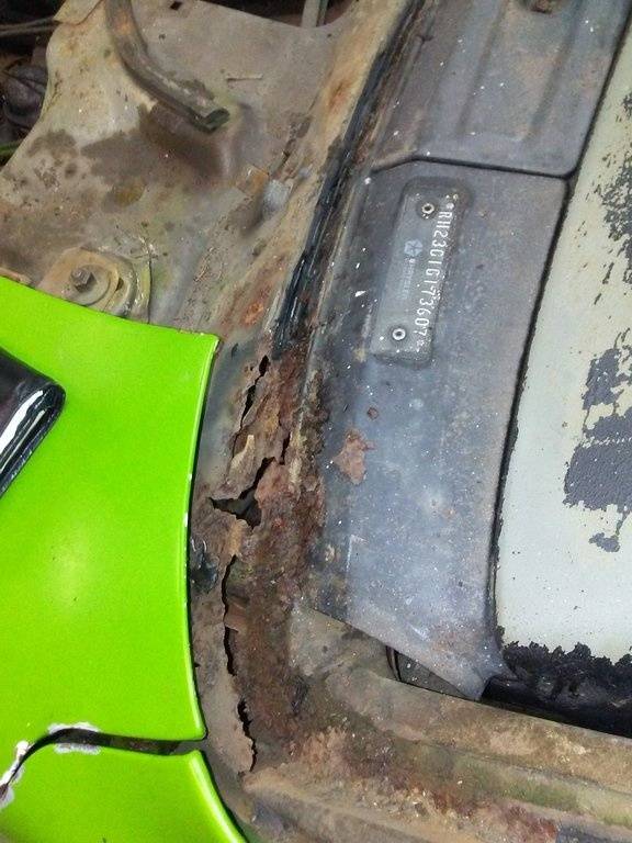

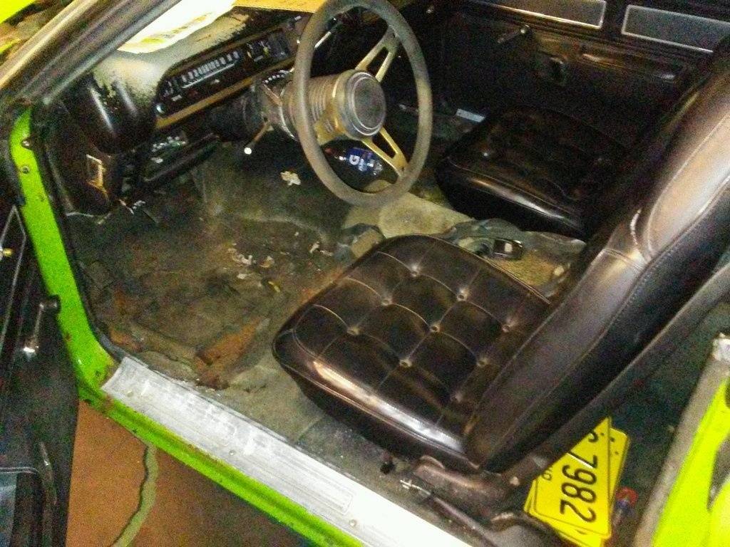

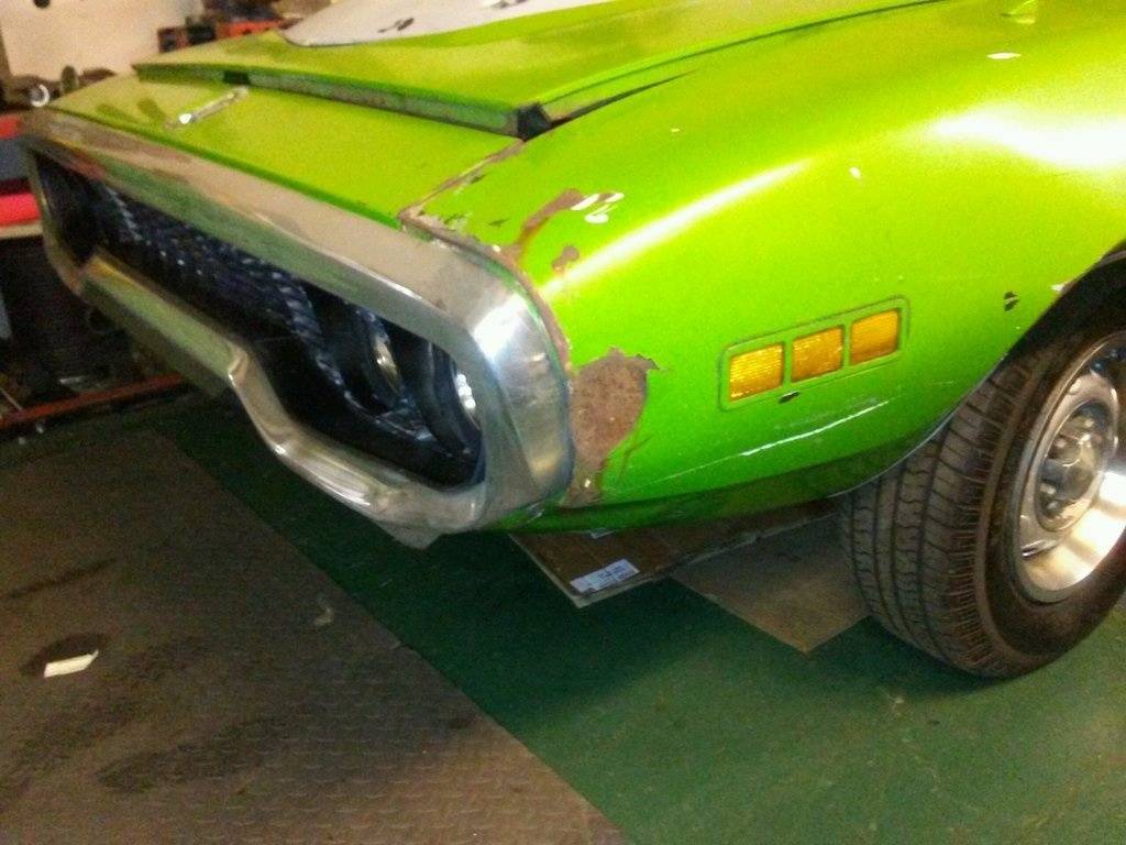

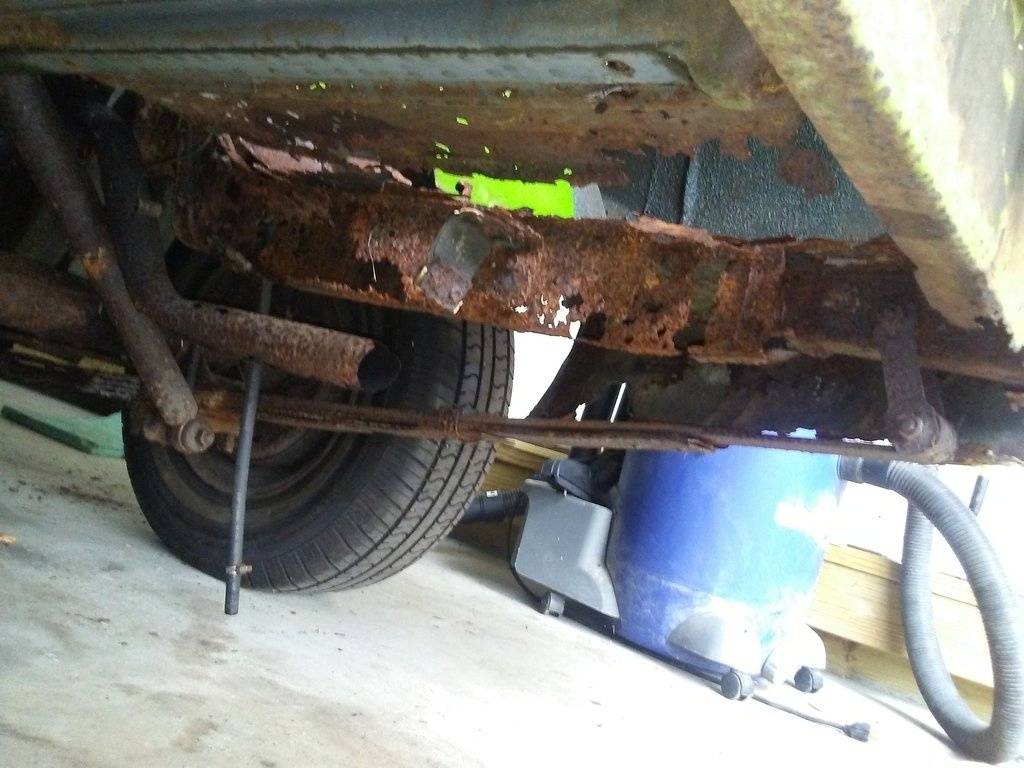

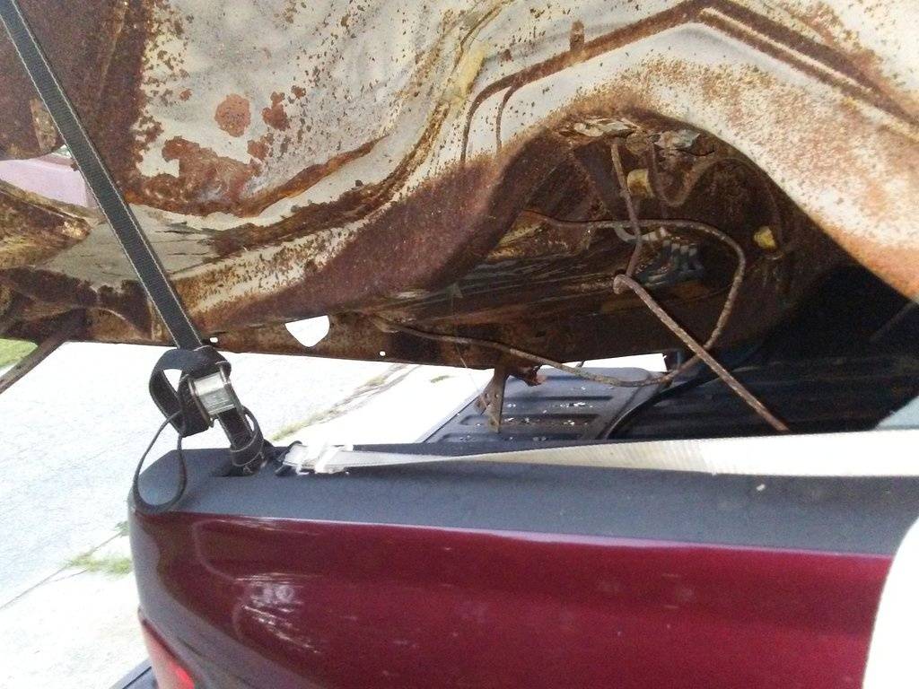

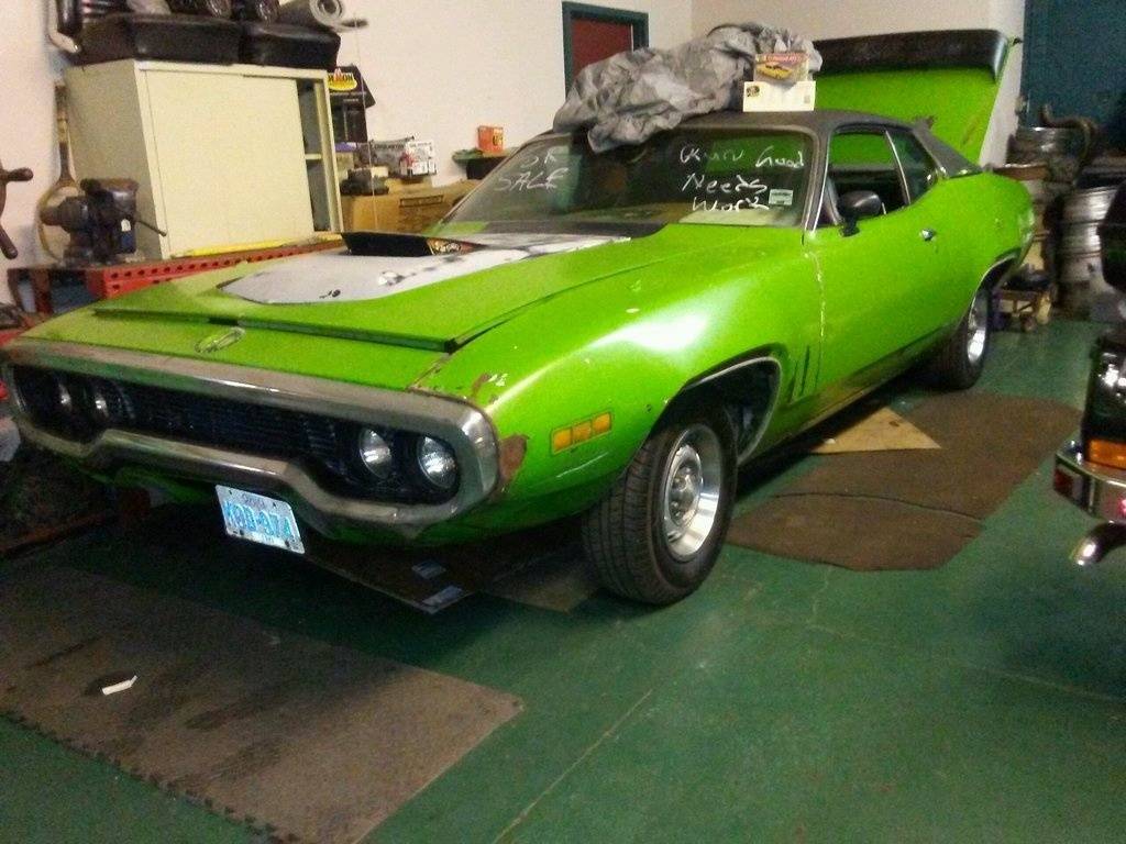

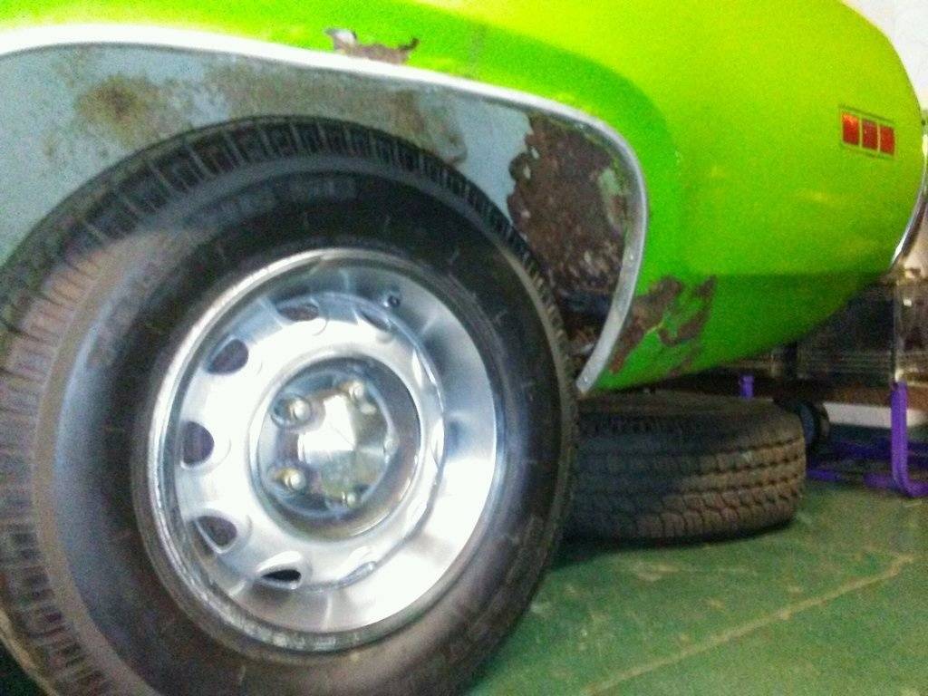

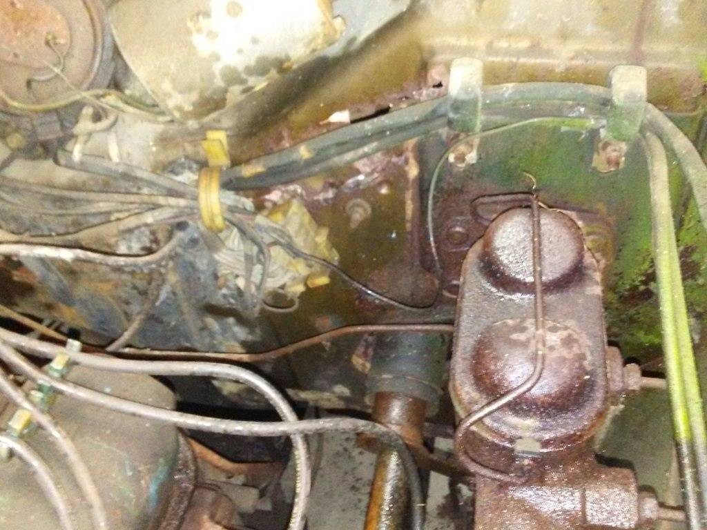

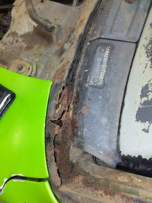

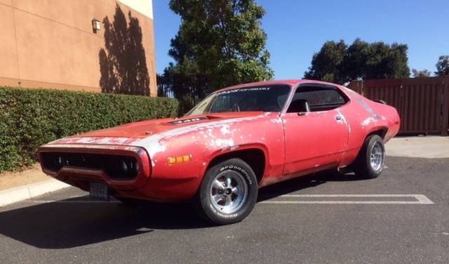

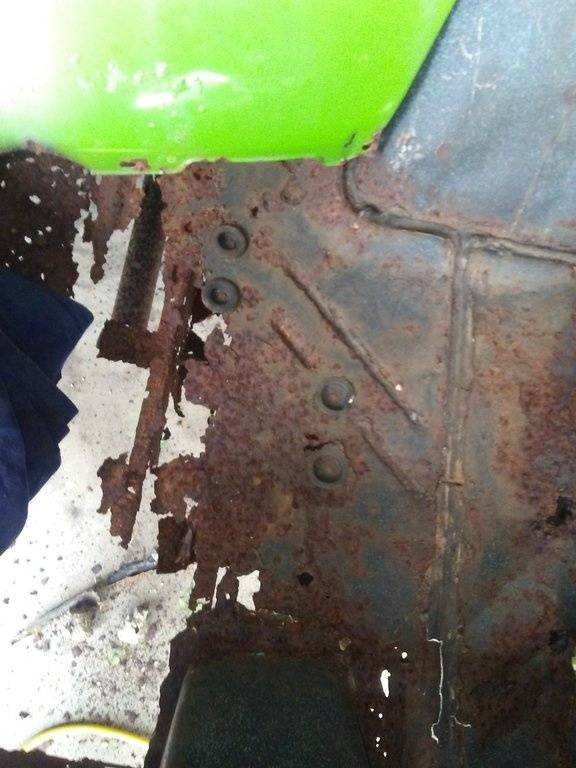

Newbee here with a project.
Just divin into this a few weeks.

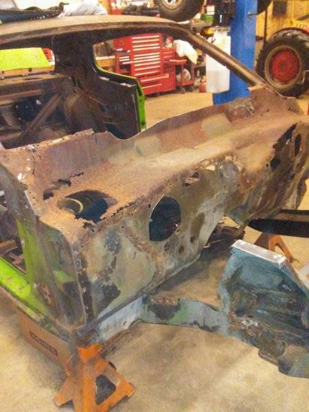

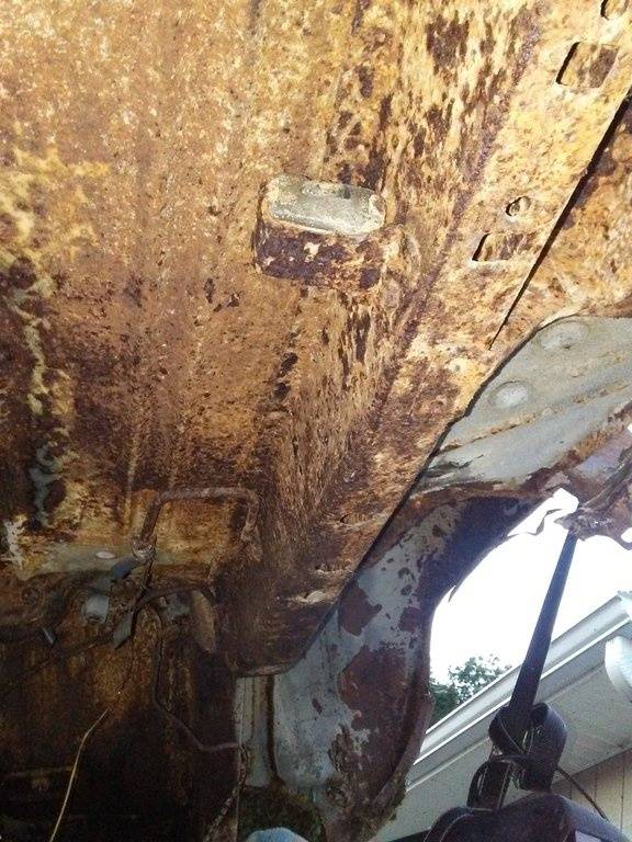

Plan on gettin all the rust fixed then will go from there...
Here are pics..
Warning: its ugly...

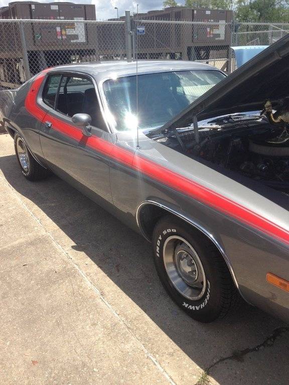

Haven't had my first mopar for long. 69 RR. I have a lot of work to do before it drives itself. But I have become crazy about the 71 and up roadrunners. Guy at a show in Gonzales had one out this weekend. Thought a few inspirational photos might help. Great color on your car. Keep posting updates.

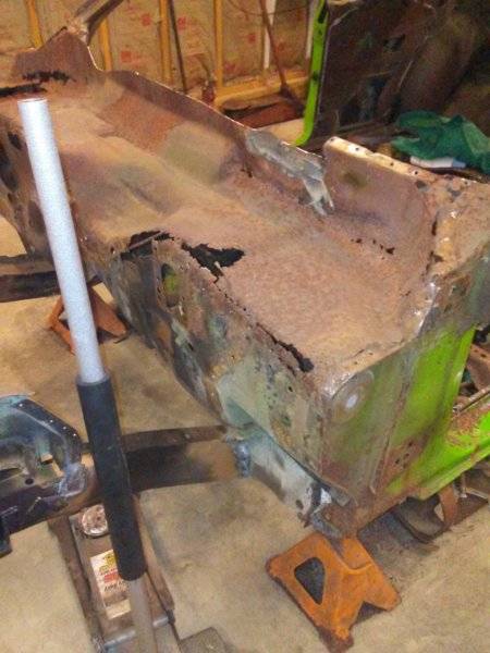

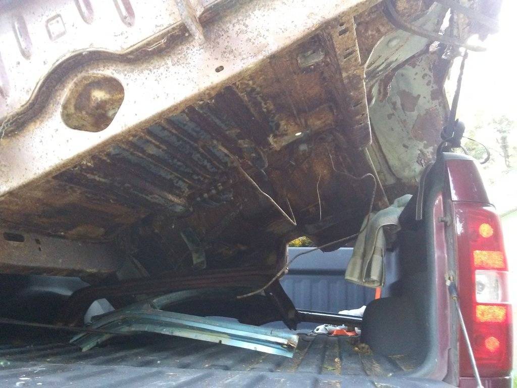

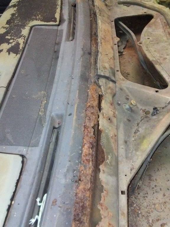

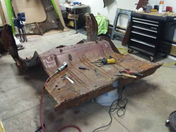

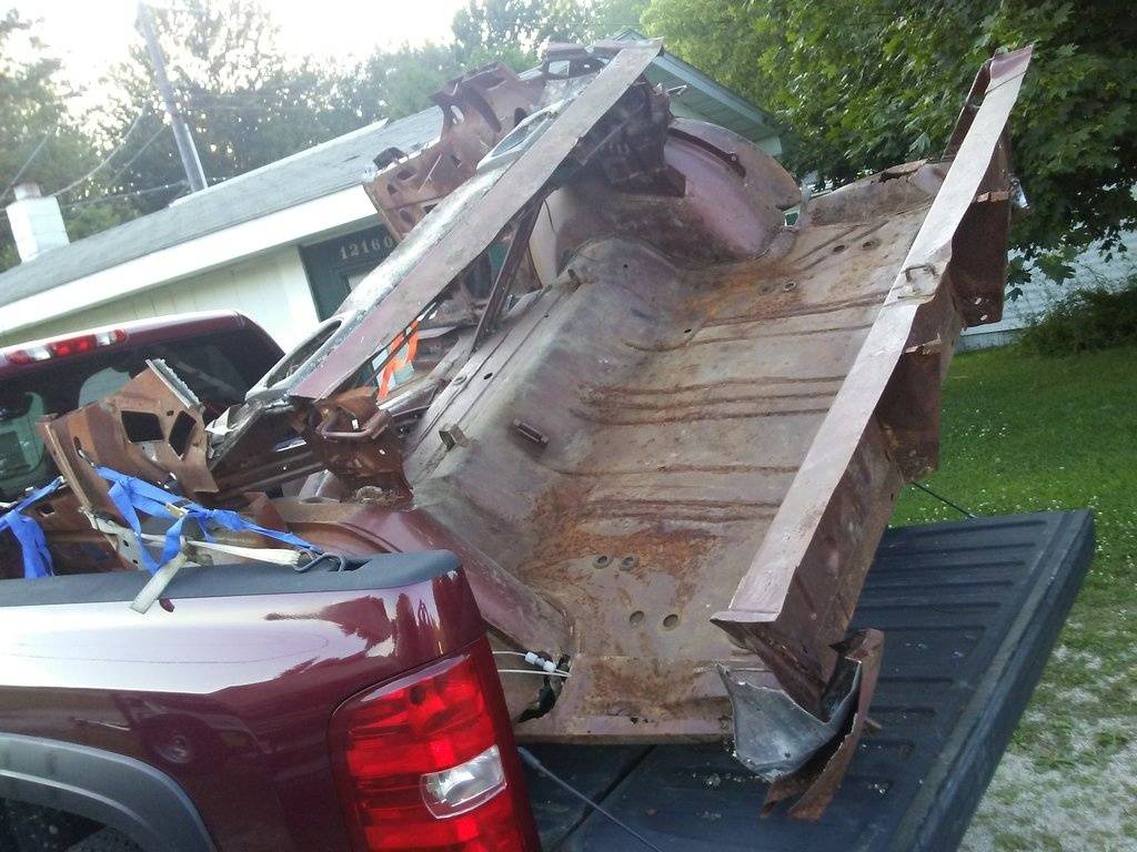

Picked up some muchneeded parts today. This cat needs a framerail on the passenger rear. Repops are all partials. Thanks to Joel over in Edinboro pa, i was able to score the rail, along with a truckload of other parts. Thinkin i might graft the whole rear section onto my car... Might be easier. Even the floorpan is nice, just a few dings that can be flettened out. Also scored a nice trunk drip rail & super clean upper windsheild frame...
Still looking for a cowl & lower a pillars...
Was this the one for 4 grand around Lake Erie?
Yup. A lot of people have seen this car for sale. Nobody musta wanted the project cuz my 1st offer for a little more than half his asking price he accepted...and he was down to $3800.

The part I'm really after is a cowl.

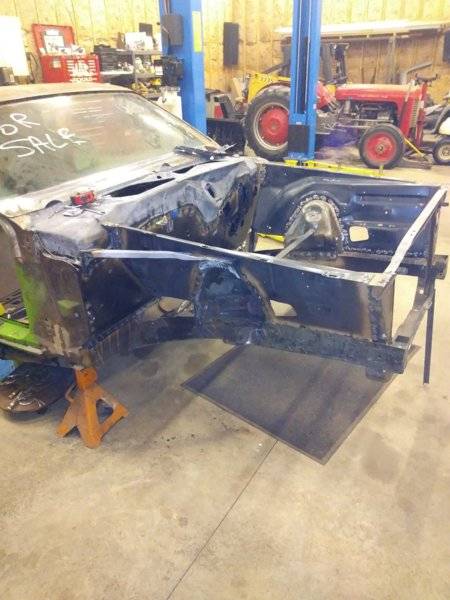

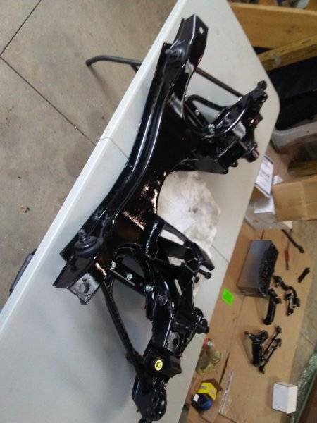

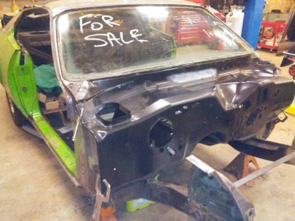

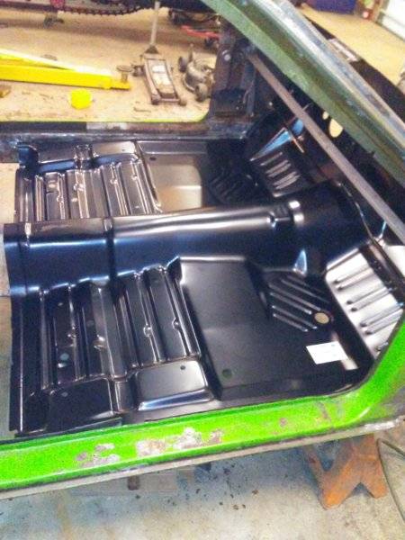

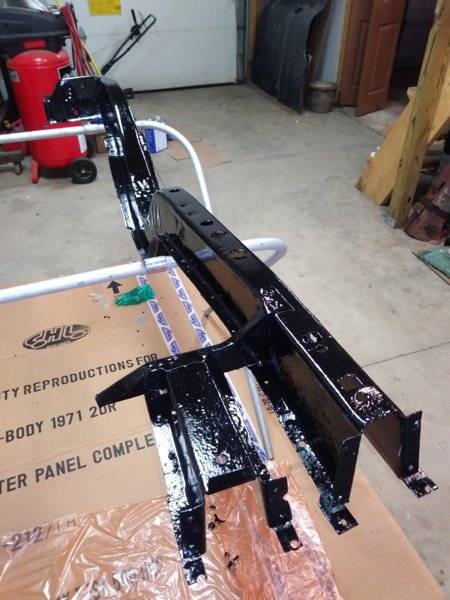

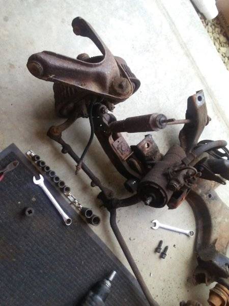

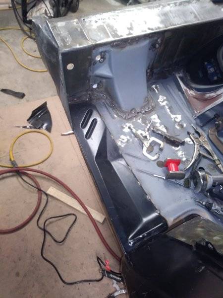

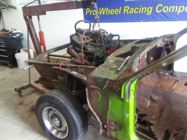

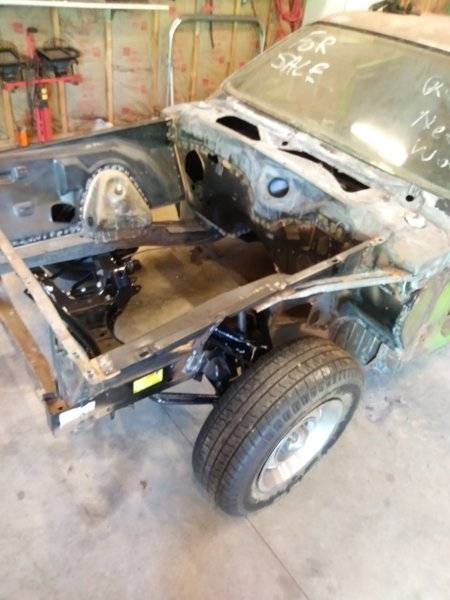

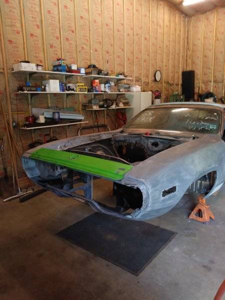

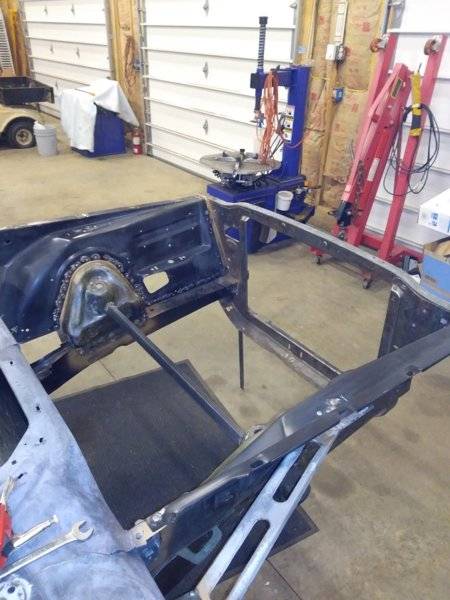

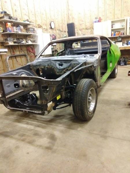

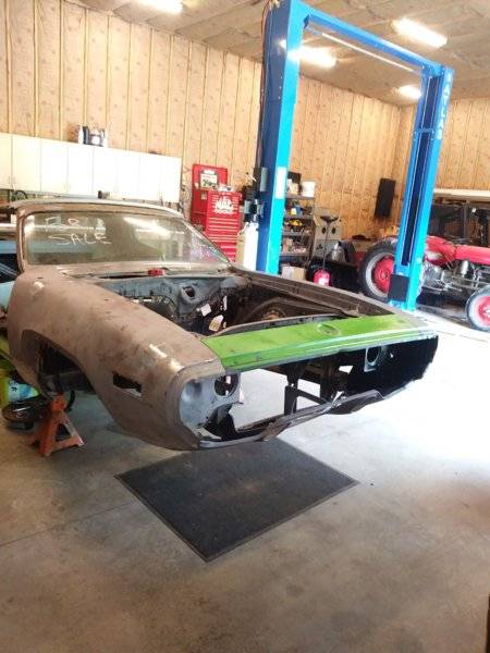

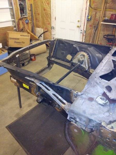

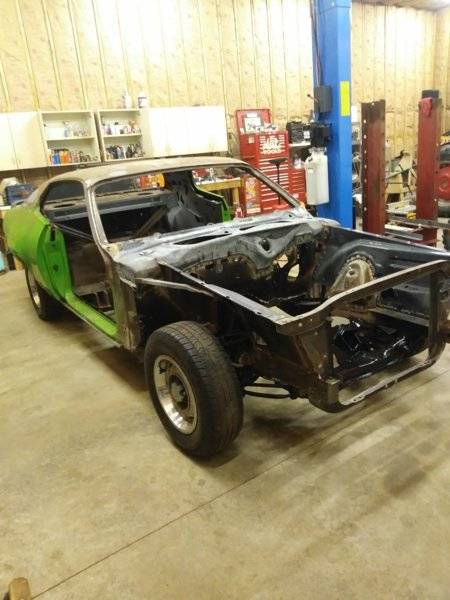

I work a lot, & things have been at a steady creep on this project. once the car was delicately stripped to shell, I decided to tackle the front of the car first. This car was moved to my cousins shop where there was more room at that point so I could take advantage of his tools & other necessities. Ended up replacing the drivers front frame rail, front floor pan, & firewall. Currently grafting sections of a Goodmark E-body cowl to my rusty original, so I can get the inner aprons attached. The sheet metal from the firewall forward is not welded in yet, just screwed so I can re-mount the front bodywork & verify dimensions before welding panels in. Here are some pics followed by another few pics-posts of the many other details that I have been working on the side for the car...

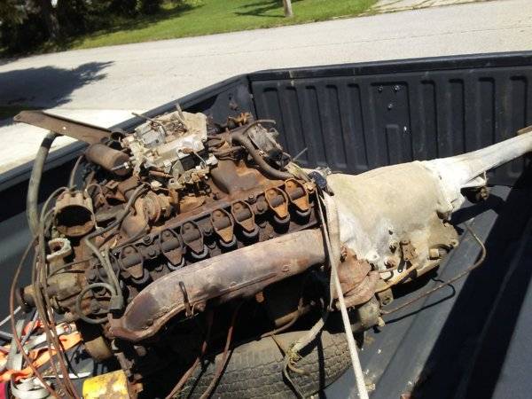

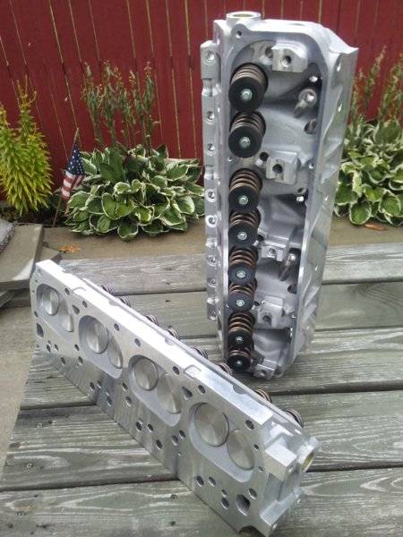

The 440 & 727 came from a wrecked low mile 75 C body...currently at the machine shop.

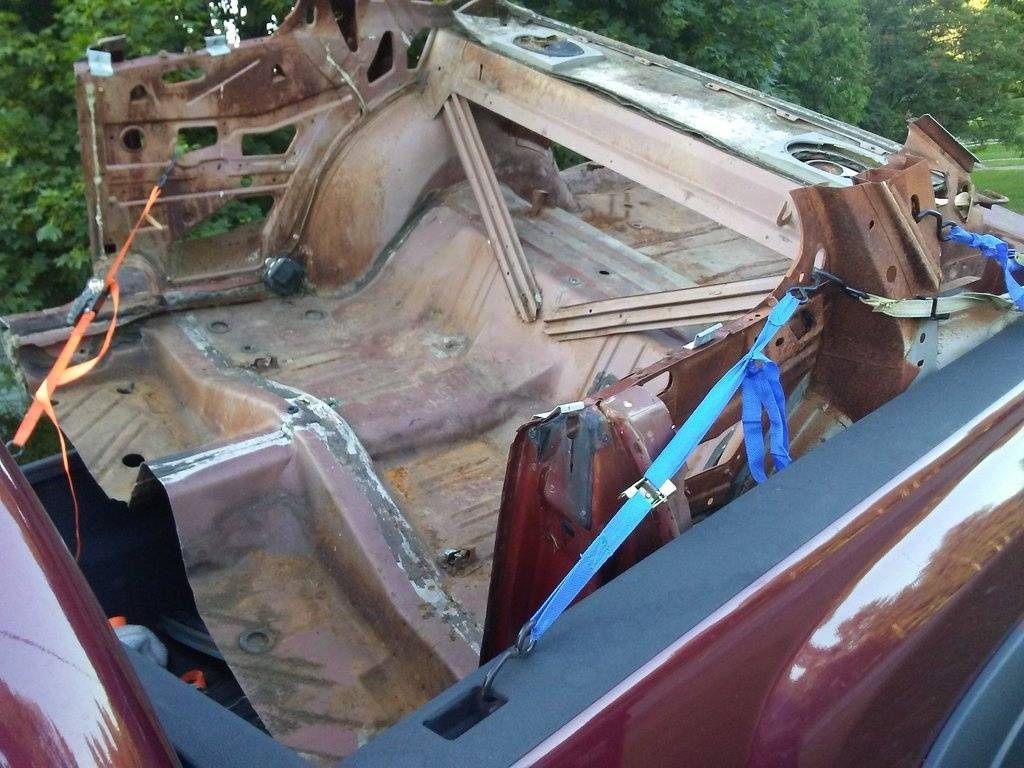

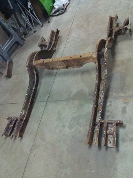

The rear frame is the stripped section of the back-half of the 73' RR I purchased for the rear frame rail. I was able to save the trunk pan as well.
Progress has been slow on this project.
My wife & I both lost our fathers earlier in the year, both of which required me to step away from this project for a while. Our families needed us. I still poked at it here & there but my heart wasn't truely focused on it for several months...
I did get my trans fully rebuilt though.

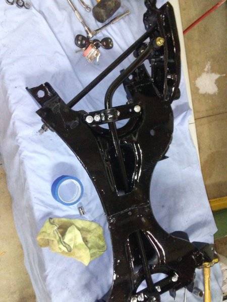

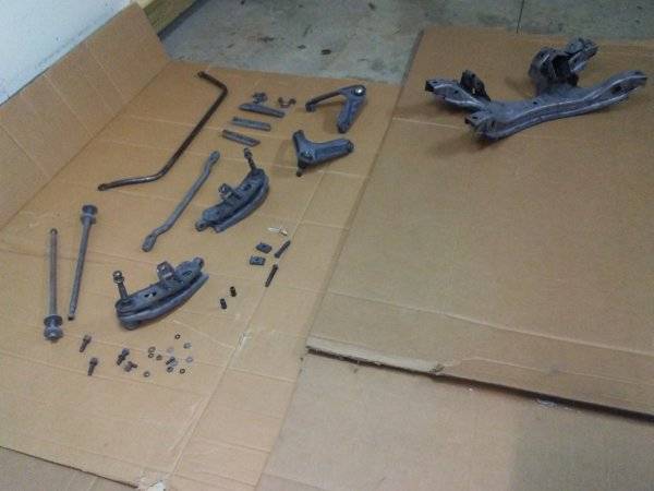

I did get the rear of the 73 stipped & am going to be able to use the trunk pan as well as the rear pass framerail. I have spent a lot of time after work blasting, priming & painting small parts(summit chassis shield).

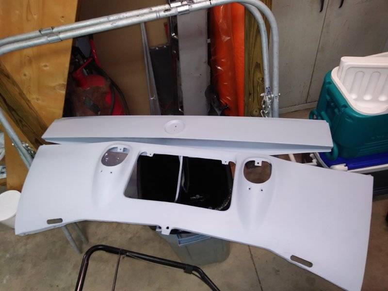

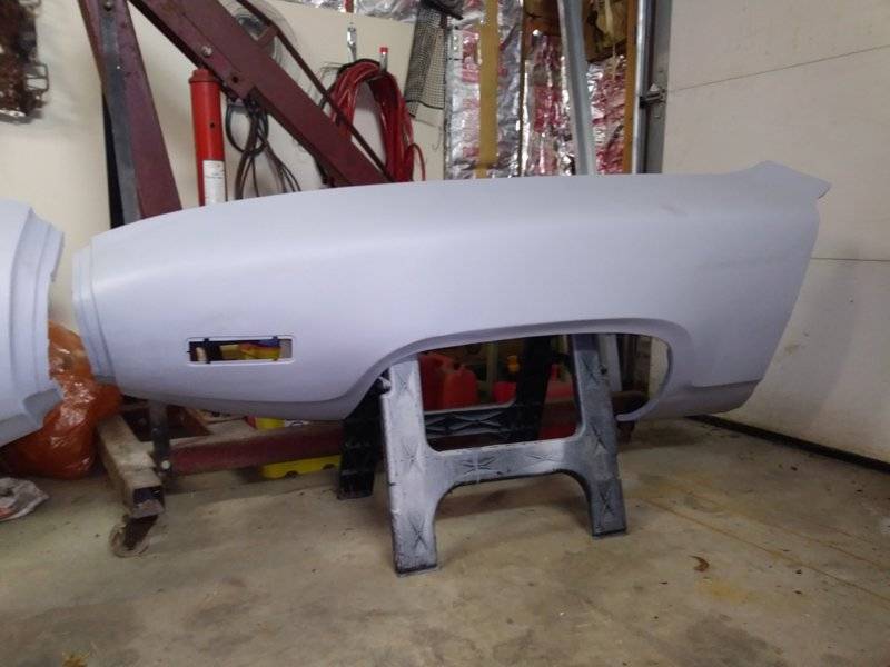

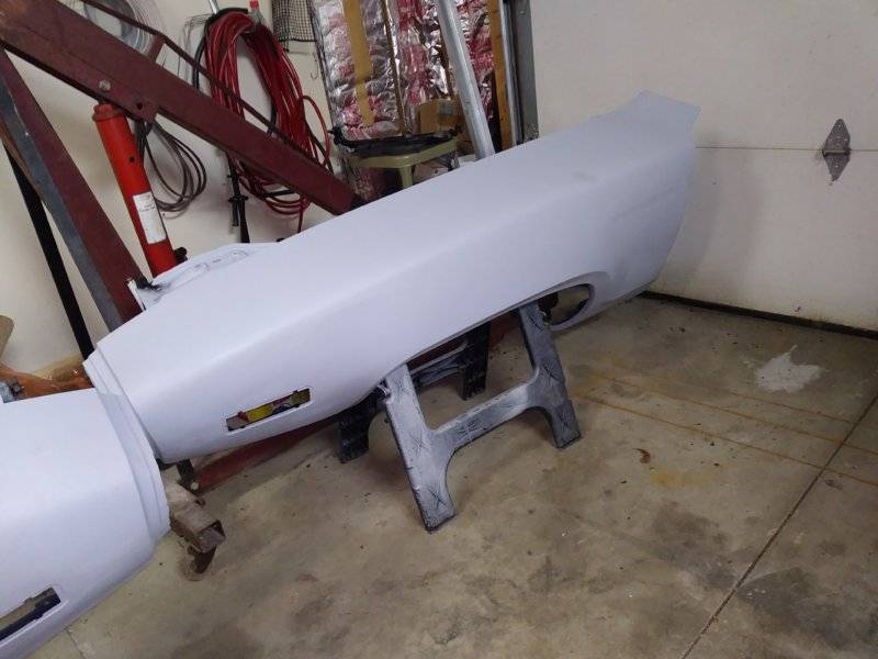

The front end has all bn welded back together, removed all the supports & jig. I bolted up the front clip sans the hood & started straightening& repairing all the damage to the sheetmetal. Those parts got primed with epoxy inside & out, inside got painted with chassis sheild & outside got 3 coats of 2K high build. They'll be stored till i can get back to the front end. I bolted the front k grame back up temporaily and assembled enough to allow me to bring the car back to my house soI can focus on replacing the deteriorated rear metal, which i am focusing on next...

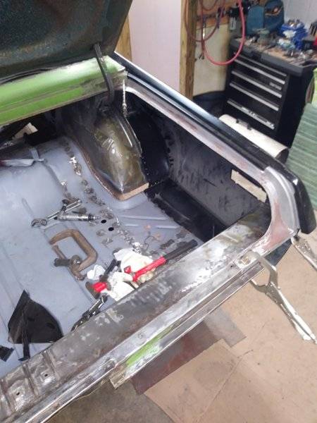

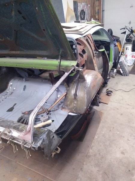

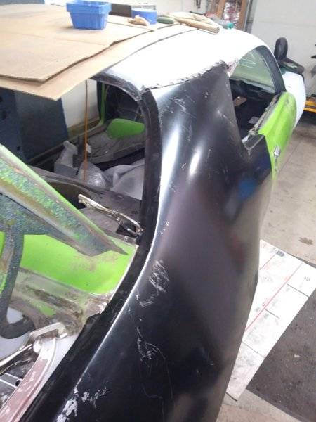

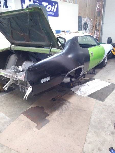

I wanted to throw an update. A lot has been done since my last update. Things are moving at a slow pace, but its me only. I had to take a 6 month break for other priorities. Work, family & a host of other excuses have slowed up the project, but I'm moving forward.

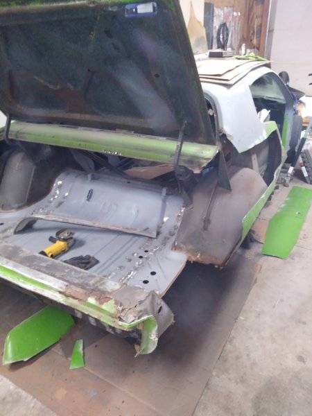

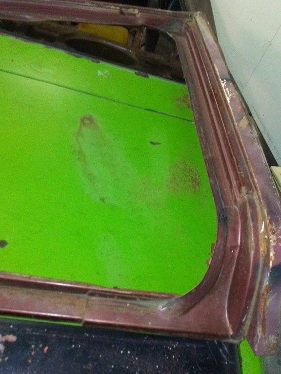

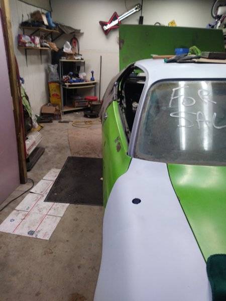

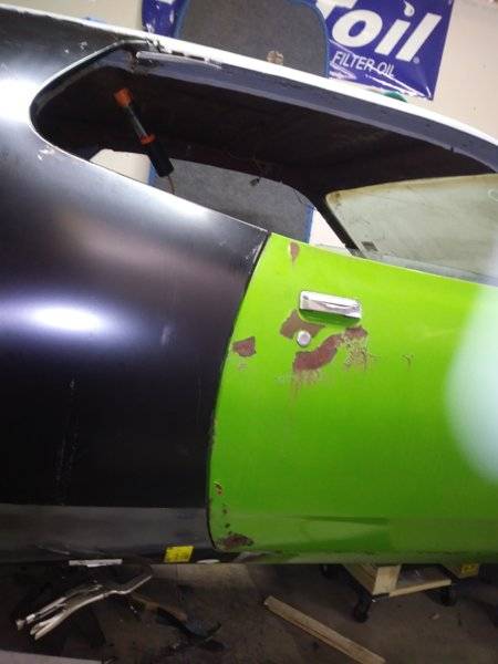

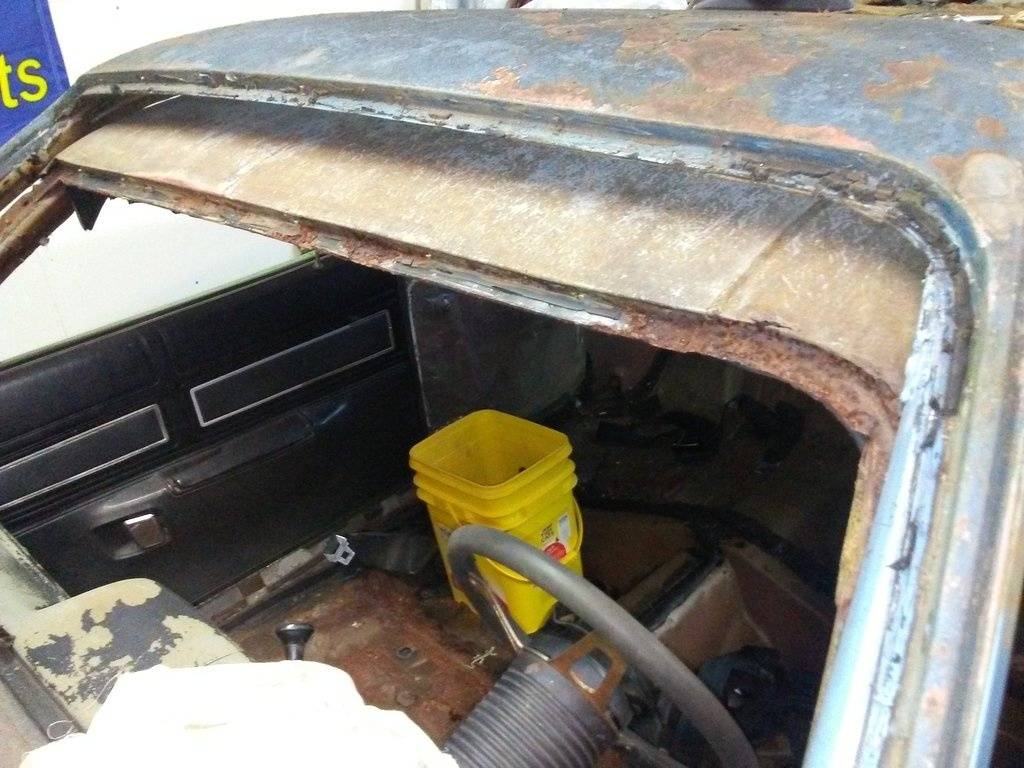

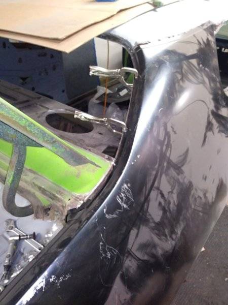

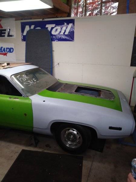

The roof around the windshield as well as some rotton inner structure was patched with the roof/windshield section I got from a clean 71 charger. Roof was smoothed, epoxy primed, & topcoated with 2 coats of 2k high build.

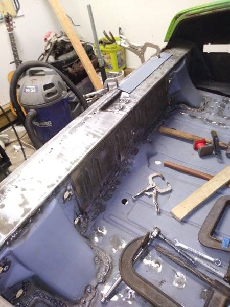

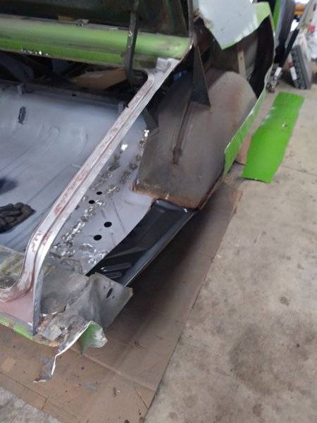

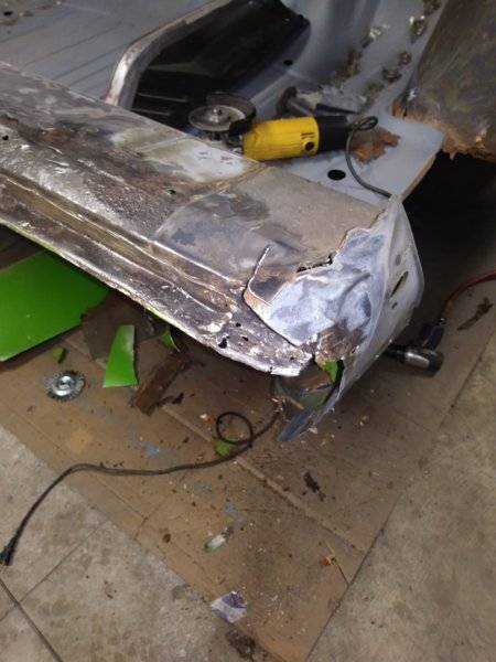

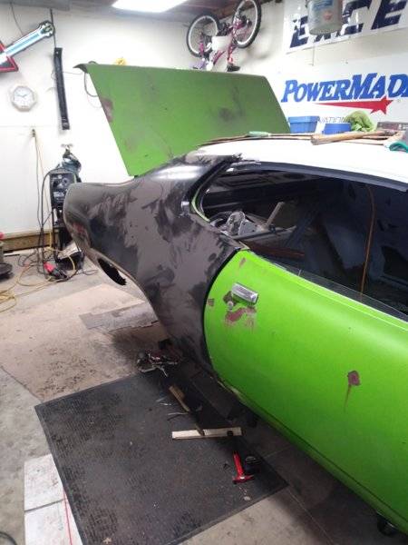

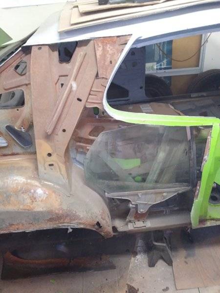

Home made jig was welded up to replace the passenger rear framerail. It was a pain to work with/around. Once rail was in, I welded in the rear crossmember & re-squared the rear quadrant. Then the used/saved trunk floorpan from the same 73 RR was prepped up & installed. A final check allowed me to get the braces welded back into the tail panel as well as some other patchwork back there.

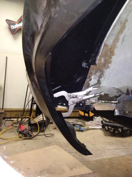

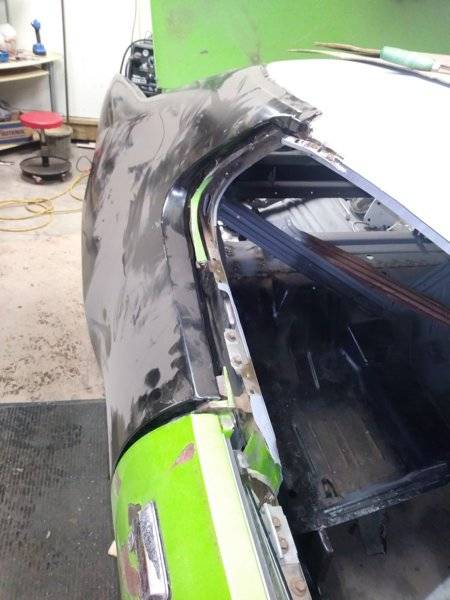

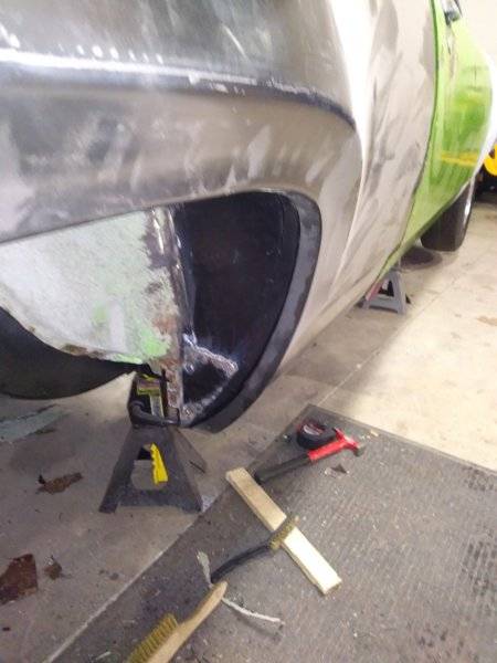

Then came the rusty quarter panel & trunk gutter removal. After finding bondo & crunched rear corner, that was repaired. The rear rocker "shelf" & end was cut out and replaced. A new AMD trunk ext was installed as well as an AMD outer wheelhouse scabbed in because I didnt want to patch the wheel well lip where it meets the quarter panel.

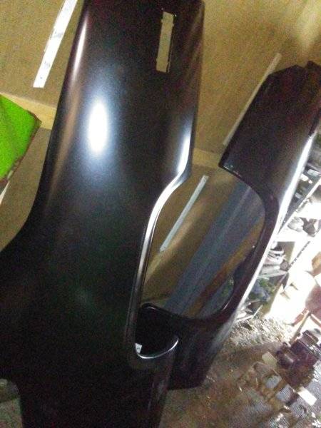

I dropped the new Goodmark quarter down from my loft before work yesterday so I could begin the nervous/skeptical test fit. I got a nice, pleasant suprise once tucked in around all the lips. Its the first test fit but fits super.
I'm very happy & relieved at the same time. I've had so much of this half of the car apart & replaced over such a long period it really made me feel like I accomplished something to see things all ligned up on the first try. I have to do a final measurement check & clamp it all tight to make some marks before romoving it & finish welding up the inner structure, prime & paint so it can be "final" installed.
