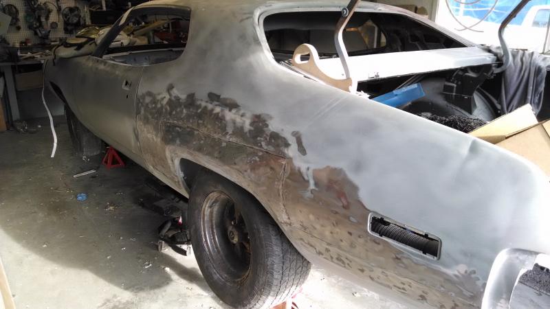

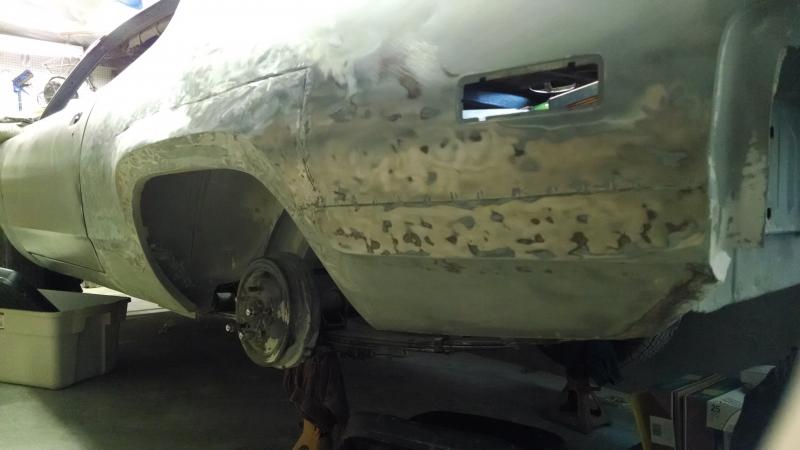

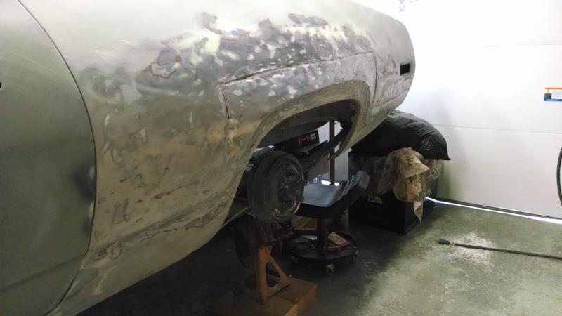

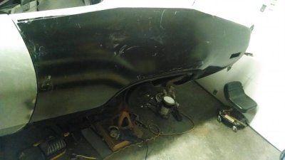

Got my quarter skin and I'm impressed with the fit. Mock up is close to complete Here's some before pics of the hack job I paid someone to do. Quarterskin i July 2014.jpgQuarterskin ii July 2014.jpgQuarterskin iii July 2014.jpg

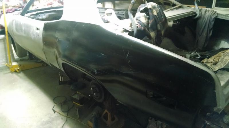

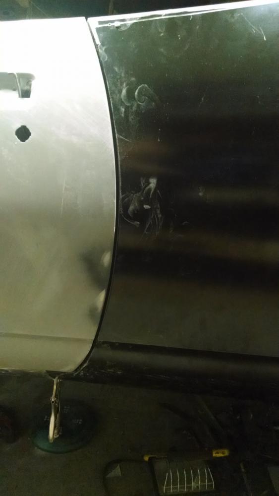

Here's pics of the new panel mock upQuarterskin 2 July 2014.jpgQuarterskin July 2014.jpgQuarterskin 3 July 2014.jpg
looks like you got a handle on it :headbang:
Had to replace both mine as well along with both outer wheel wells. Makes a world of difference. I had the welding part done, now I'm working on the body work to get it all blended in. Really happy I did it and didn't just try to patch the old ones. Your's looks great!
Thanks Pappy.

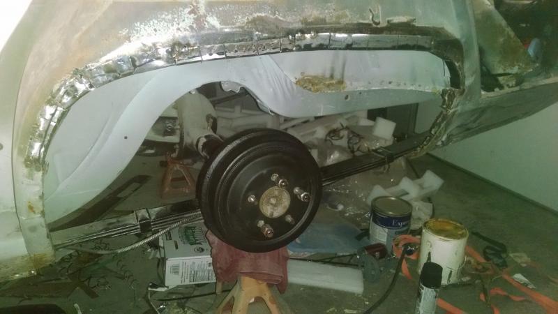

Had to remake the inner wheel well lip. Took aleft over piece of sheet metal, hammered a 90 into it, cut into four piece, cut some slits in it to mold the shape and welded it in. Found the trick is to weld high and pull the fold down to the outter fender, then tack them together.IMG_20141103_173459734.jpg
