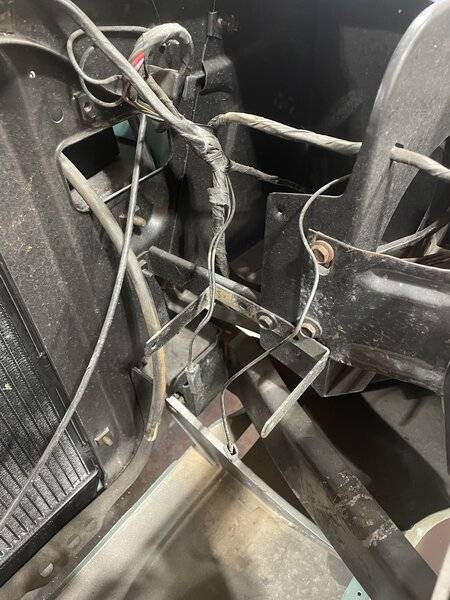

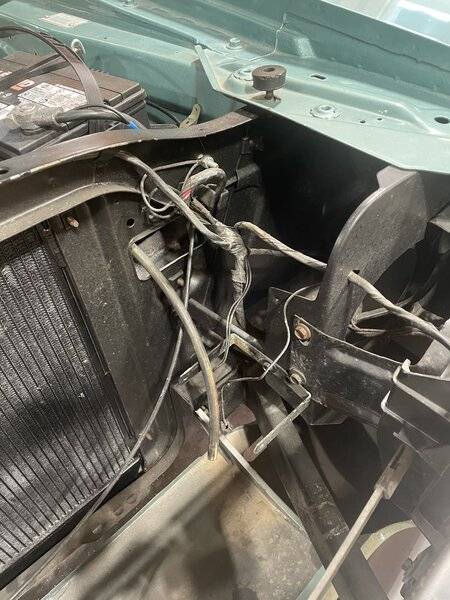

In that vast space in front of the radiator (my wife thinks there should be some custom luggage for the space) there is a bracket, driver side, in front of the radiator that has several wires going to it. I cannot figure out what might have gone here.
Any ideas?

maybe somebody added an over flow jug for the rad. You can see the hose from the rad right there. The wires could be for something else? Just my 2 cent.
It looks like your radiator overflow hose leads right to it, so I'd say bracket for a missing aftermarket overflow bag or bottle.
I agree with 41
However
For the life of me I can’t remember where the washer fluid jug for the concealed headlamps washing brushes was mounted
Very rare option
Do you have concealed headlamps ?
Those wiring harnesses where part of those options
I just saw the concealed headlamps door rod in that second picture
Fender Tag
A09 - Concealed Headlamps
J24 - Headlamp Washer
Beer cooler wiring. I'm sure I'm not the only one that hauled a few cases of beer up there back in the day.
