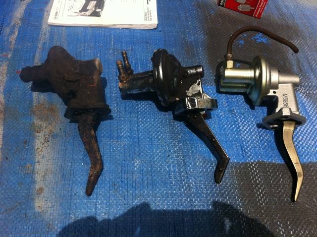

I don't know why I didn't think to pull the one off my parts car just to compare the pumps... But that's what I did here, and I think I figured it out.
The pump on the left is the one off my parts car (72 Sat Seb 318 car that has been inoperable since '83). The pump in the middle is the pump that came off my car (72 SSP 318) and was working up until recently. And the pump on the right is the new one.
Comparing the one that came off my car to the new one, they look completely different, BUT comparing the new one to the one off the parts car they look very similar.
I found a use-able fitting on the parts car which will allow me to make the new pump work.
So anyway, I just wanted to update this so you guys don't think I'm just flipping nuts... I sure thought I was for a while. But you can see the differences are quite substantial, hence my original concern.
