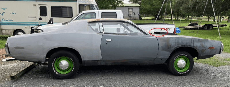

72 Charger with no ac in S. Louisiana. Where is the fresh air intake located? I mean does it come from somewhere under the hood? Cowl? The air coming out of the vents under the dash is hot as all get out. I'd do some investigating in the car but I'm at work in the Gulf and just thought of it.

Circled area is the culprit. I very seldom drive the car fast enough for the cowl induction to come into play. I think the scoop is probably too far from the cowl to really work anyway. We bought the car like that. The previous owner was gonna race the car. It's also got an Edelbrock air gap intake which prevents a flat hood from closing properly. I may try a very short air filter and some sort of cold air intake getting air from the front of the car.

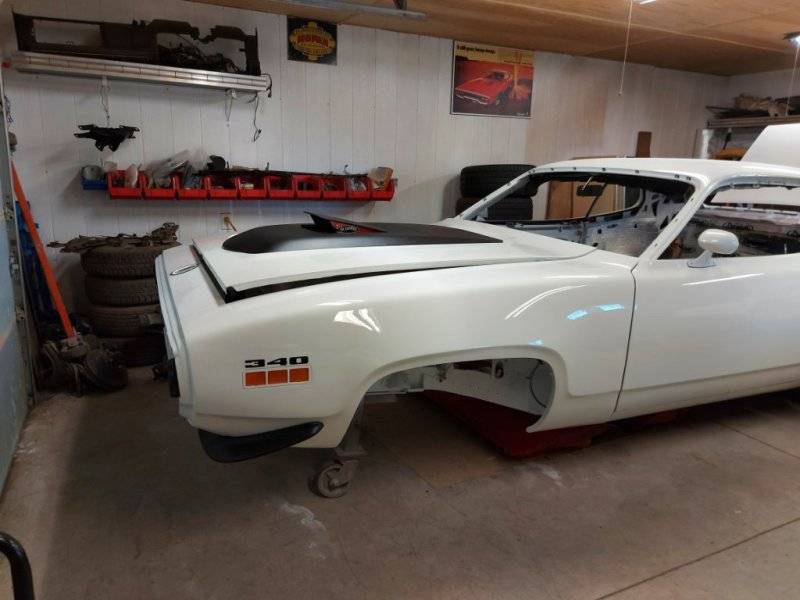

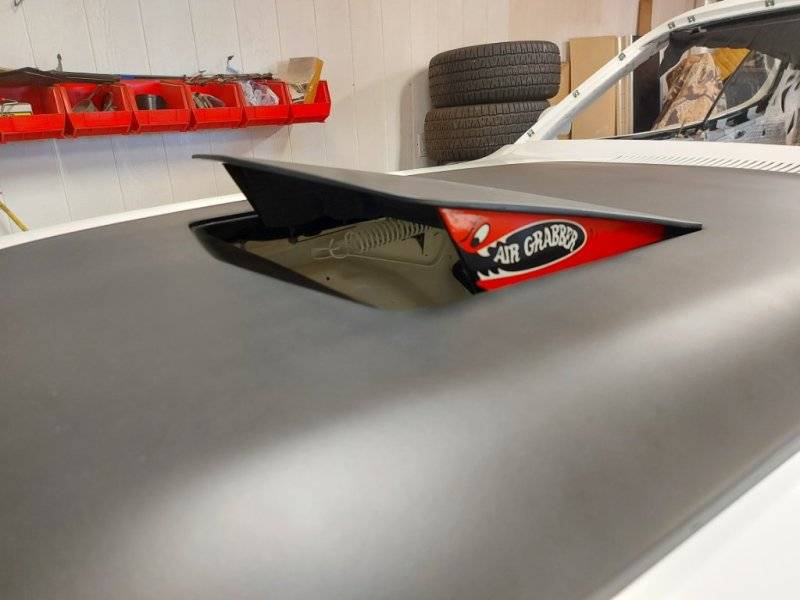

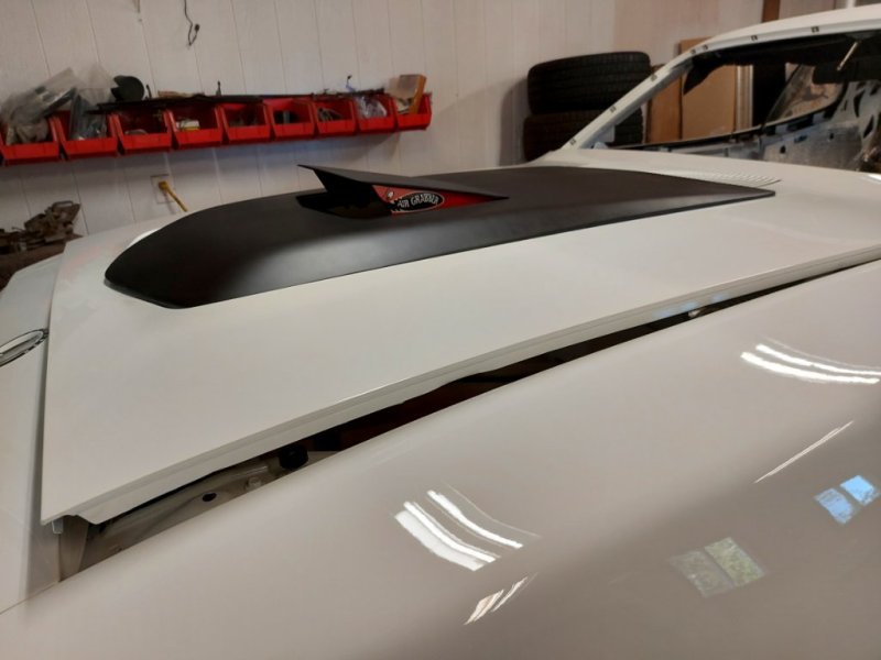

Tazz, get rid of that set-up and go with an Air Grabber set-up.
I bought mine from the Stinger fiberglass company - I'm not using any under hood components.
I fabbed it to stay open.
Those Plymouth AG bolt on setups don't work very well on Chargers, as they are designed to fit in the recess of the Plymouth only hood.
...and IMO, don't look right on a Dodge. For a Charger, you really need the whole AG hood.
