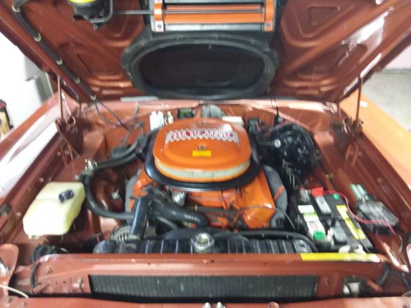

Hey believe my 72 Charger came with the fresh air ventilation that passes through the vent in the top of the hood and then into the cabin.
Whenever I turn mine to vent and turn the fan on all I get is very hot air, which I believe is coming right off of the engine. Am I missing a part that would make a tight seal so engine air doesn't get into the vents or do I need to replace the rubber seal under the good?

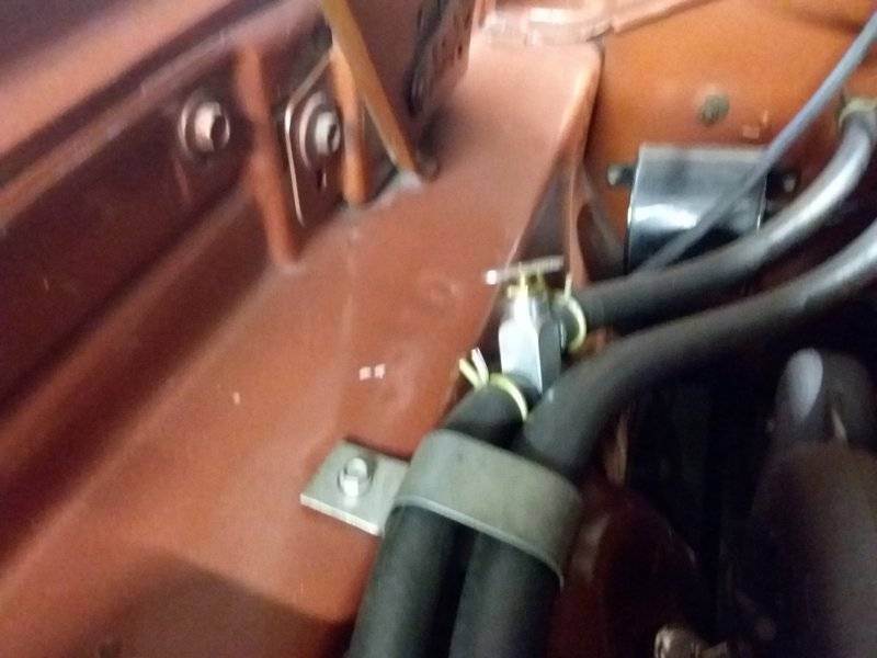

Did he remove the water temp valve and you have heat on full time? Let's see a picture of your heater hoses at the firewall and inner fender.

In pic 2, you can see the temp lever towards heat.

Here is a picture of the water valve I believe. Should it be link shown for no heat or the other way?
I have not found a heater control valve that actually seals off and stops the hot water from going in to the heater core. I have disconnected so many of them to get the ac to blow cold. That may be your issue.

I fully believe, as has been stated above, that you have some hot coolant slipping by your heater valve. I ended up installing a valve in mine so I could shut it off in the summer and then turn it back on in the winter.

I don't have ac in my car but what did helped allot with cabin temps, I cut my heater hose inbound to the core and installed a shutoff valve, closed off all summer and open in colder weather. Cut the temperature a noticeable amount.

I like it. Any chance you can post a photo and/or part # for the valve?
I've got a generic RV valve in mine because the "correct" valve is astronomically priced and the last one I bought leaked.
It was $12 at a local RV supply place.
BTW- AC and non-AC cars have different valves.
