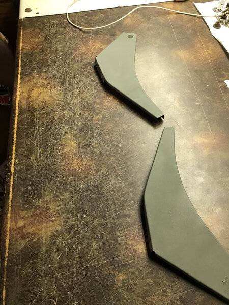

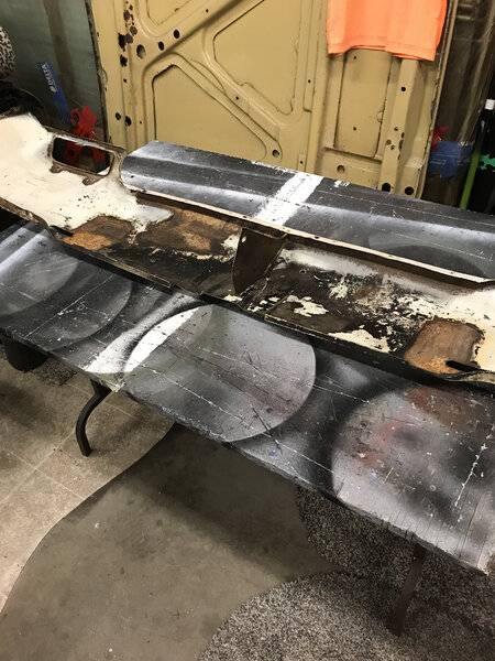

I was going to restore my front valance on my 72 Charger and noticed that it had two of the spot welded brackets missing.The center one is still in place.I have the outer brackets for it now and was wondering if anyone had the measurements for the bracket spacing so I can weld them on?
BB3153B8-1915-4E1A-B073-CEF7161F8314.jpeg 2F3D3C8B-CA7D-41EB-9B84-ACAD5F9D1363.jpeg
I just need the distance from the center bracket to each side of the outer brackets so I can weld them on.Thanks

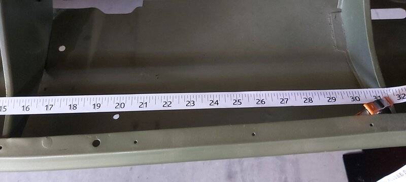

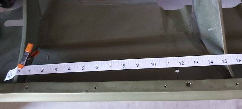

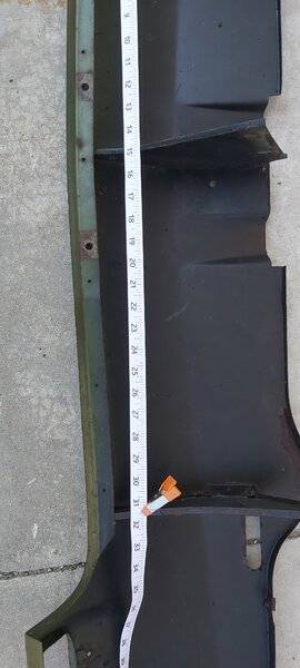

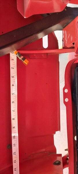

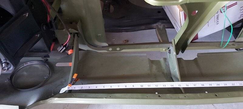

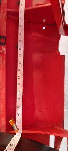

DS 16 1/4" PS 15 1/4". I can get you a picture later beside a tape measure.
Thanks for the measurement.A pic would be great when you get a chance.Thanks again
