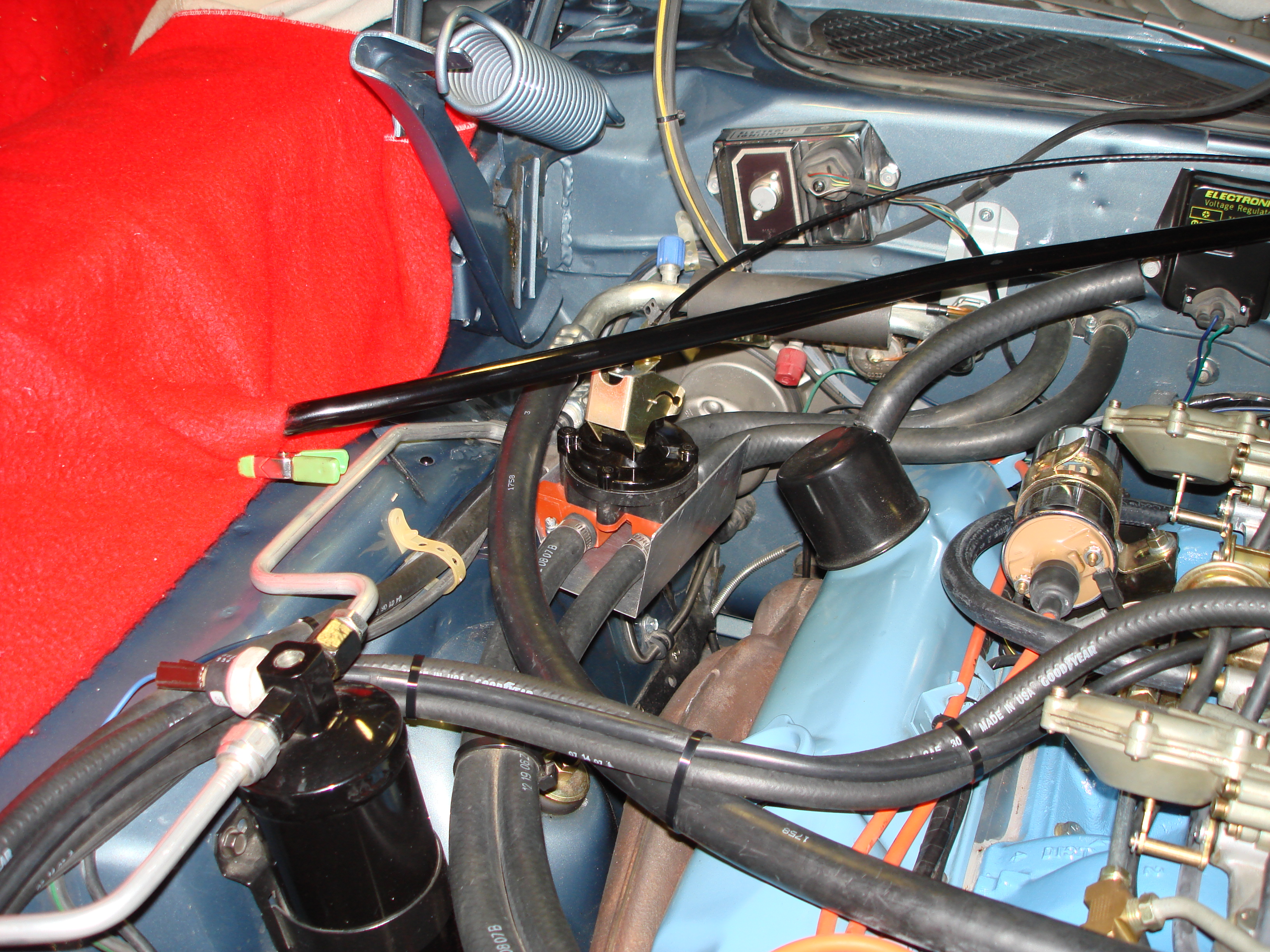

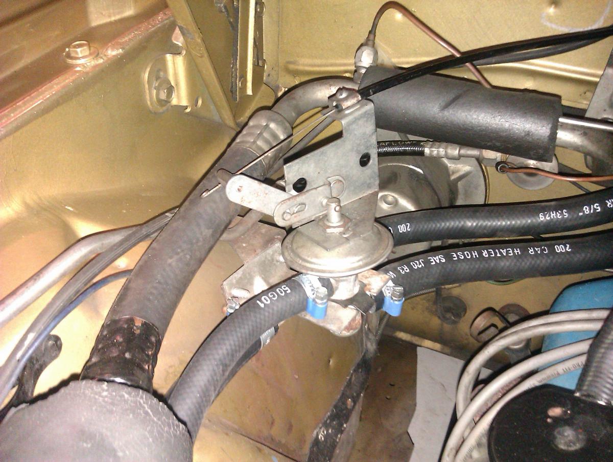

On my 72 Charger my heat control valve are broke - I cant find in same design - anybody know where to find or what can be in use instead

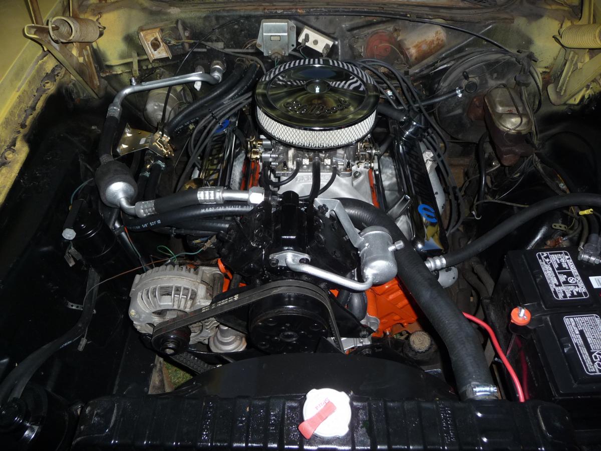

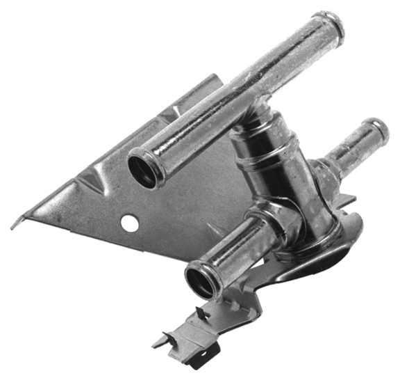

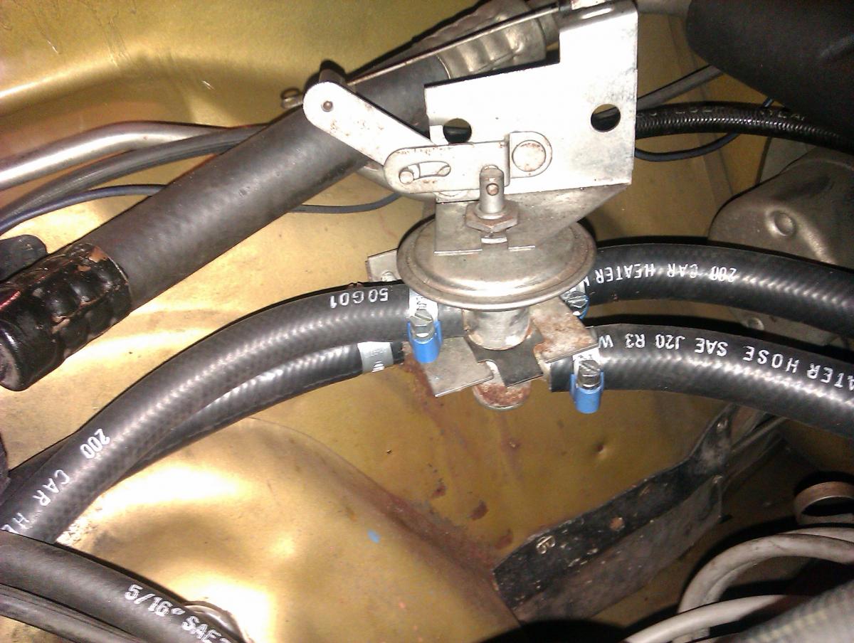

Yeah, I've never seen one quite like that either. A few months ago I bought one from Napa. Mine is cable operated just like yours and it looks like the bracket yours attaches to is the same required to fit the one I bought as well . do a search on the Napa website to see if it will work...the part number is 660-1235 and I paid $58.49 for it back in the summer. Sadly, this is about the only picture I have of mine showing the valve.

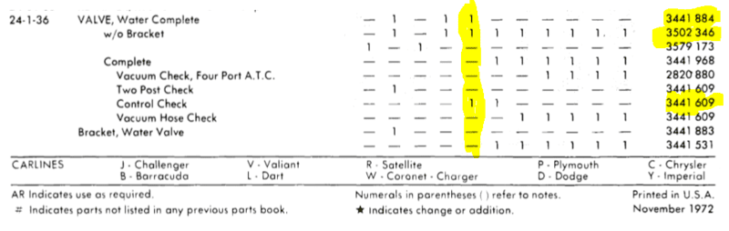

Old thread, but I just ran into the same issue with my 72.

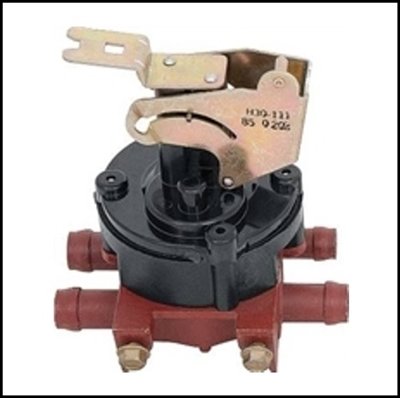

Maybe these are direct replacements that are no longer available.
This appears to to correct. $200-250 online.
That's what I did. thanks for the info. besides, $200,00 for a heater control valve is out of control.

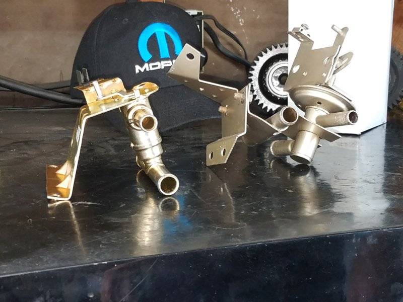

THAT IS IT! I looked all over for that valve. ended up using the crappy universal one pictured.

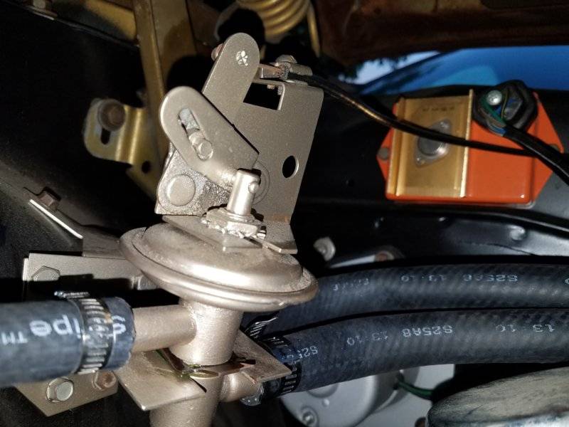

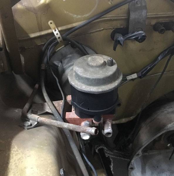

Since we are on the heat control valves, let's discuss the 71 vacuum operated ones. What's out there for these?

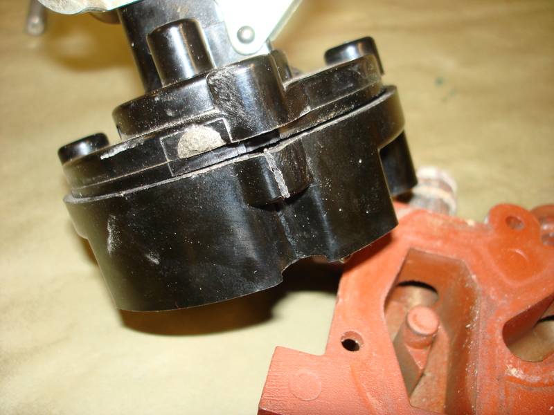

The early versions of the OE valves, vacuum and cable operated, had a Bakelite valve body and were prone to cracking in short order due to heat exposure. Later versions moved to another composite for the valve body. If running one, recommend shielding the valve from radiated heat from cast iron exhaust manifolds, especially the HP versions.
