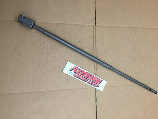

A previous owner had cut the steering shaft just above the coupler where it connects to the steering box.
My question is can I use a steering shaft from an automatic on the column for my automatic floor shift column? Are they the same shaft? If not, who would sell one? Couldn't find one at classic industries.
Thanks for your time,
Bob.
Different shafts for power versa manual steering. No difference between floor or column shift.
ps shafts are shorter then manual so that is what you need to remember. Might be cheaper to buy the whole column this was on EBay
