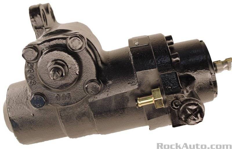

You definitely have something unusual with that steering box. Closest I found was a Firm Feel on Rock auto that looks similar being I don't see a way to adjust it either. Please keep us up to date on what it might be.

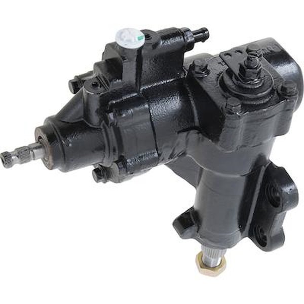

Is that the new box from Lares ? I’ve read on this forum that they offered rebuild original Mopar chucks but branched out to offer all new units built with a closer ratio. So many of us have switched to the Borgeson unit but it is nice to see options like these come along too.

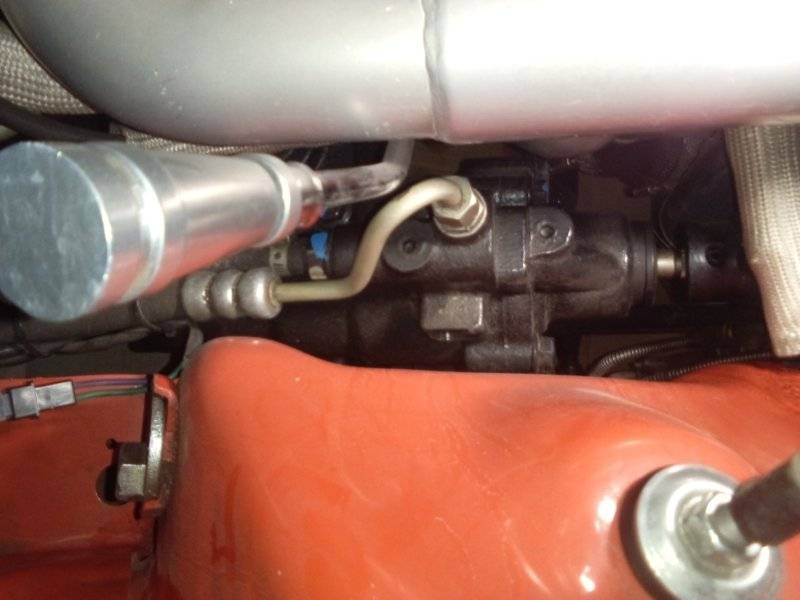

If you are asking me I don't have a clue. That is what I am trying to find out however as I mentioned a 40+ year red seal mechanic friend of mine said he has never seen a P.S. box like the one currently in my car and although there is the screw/nut adjustment on top of the box there is no place that has the two bolts to set the steering wheel so it doesn't jump to the left or right when you start the car.
Wouldn't that round cap with the four bolts be for adjustment or is this piece part of the screw/lock nut adjustment?

The P.S. gearbox in my car right now has the screw and locknut adjustment but not the adjustment when you loosen 2 or 4 bolts and tap the plate about 1/64 inch so the steering wheel won't jump the the left or right of center when you start the car.
