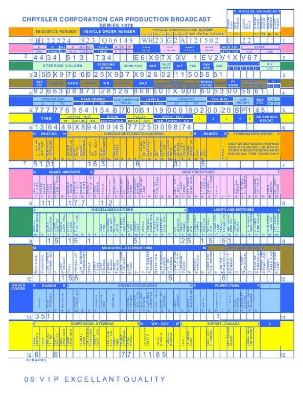

Found my build sheets under the seats after 42 years of never being removed, there was actually 2 identical build sheets, one under the passenger bucket seat, which was in poor shape, pretty much a puzzle to be put together, and the other was under the rear bench, and was mostly complete with a couple small tears and wrinkled, currently got that one in between some books being pressed back into shape by about 30 more books on top of it. Since my fender tags are nearly eroded away, I'm hoping the build sheet will shed some light on all the options this car has.

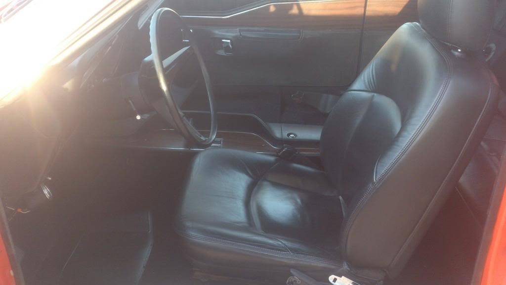

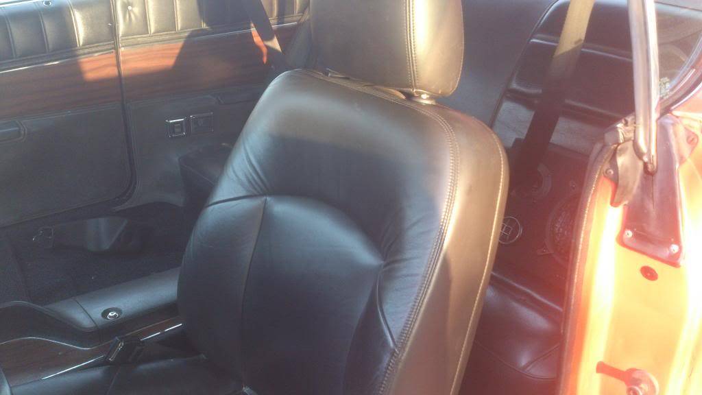

Finished one side, the driver side is carpet/seat/trim buttoned up, tomorrow will finish the passenger side, and holy crap, the Lincoln LS seat feels sporty, comfortable as hell, and the leather makes it look cool as....with the new carpet. Sorry about the pics, a little bit of sun glare interference, oh, and I adapted the seat to use the oem seat belts and oem seat slider/tracks. They look like they belong in there, they go well with the oem rear seat, and the size of the seats were perfect.

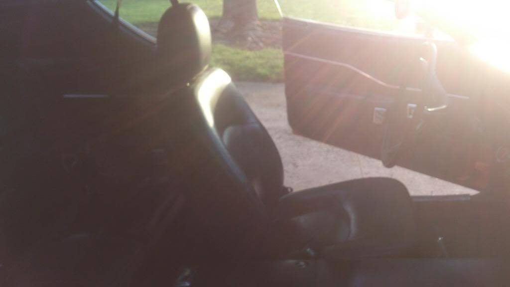

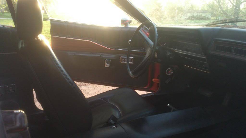

Wow! those seats look great!
+2 on those seats, they look great! - That is pretty cool you found the build sheet, awesome!
yeah, it's more wrinkled than anything, I filled in the couple missing numbers on the scanned copy, referenced from the other build sheet that's tore into pieces but is legible.

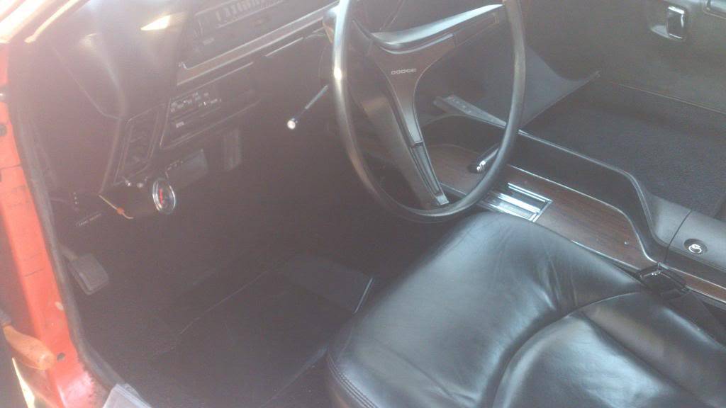

And the interior is finished, I'll get some new better pics when I can.
I used a blank online copy of a 71 build sheet to make a readable copy for my records, I would like to find an online copy of a 72, they're a little different.
