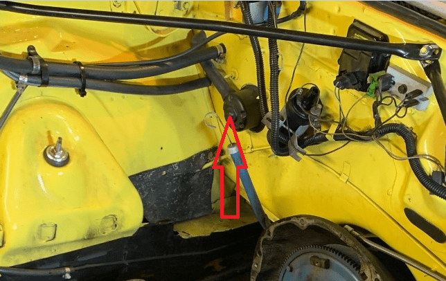

Hi All, I need to remove the heater box to fix a core leak. How does this thing come off?
In any case not from that side... The motor comes out along with the complete heater box.
Just did that job on my 71.4 nuts on engine side of firewall, one rod inside on top left of box, and all the control cables need to come off, then you take out the box.
SO that black thing the arrow points to... I don't do anything with that?
Just remove the rubber cold air hose and the motor will come out with the box as mentioned above. Pulling the glove box liner really helps when pulling the box.

Oh I see, thanks. My first time doing this.
