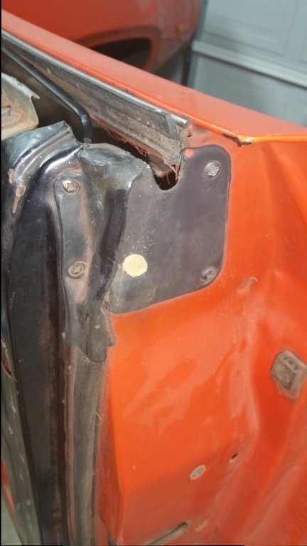

Thanks for the information! Were you able to find replacement rubber like gaskets that goes over the outside edges or did you reuse your old stuff? Mine has deteriorated.
I don't know what you mean about "outside edges" but I can tell you all the window weatherstripping, rubber and felts, are available in the aftermarket
Here is a picture of what I'm referencing. This one is actually okay but the others are pretty bad.

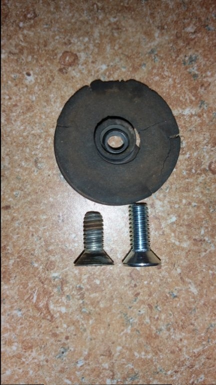

Did you use the same style screws for the track/window mounts? the four that attach the cross track to the glass itself? Meaning were they flush against it? if it doe not have to be flush, I believe I can find some screws that will work. I can not find those style screws anywhere online! They sell everything but those. Classic even has the rubber mounts but not the screws themselves.
I located the proper angled headed screws that hold the track to the front side windows as second hand parts from the window installer guy. They were "used", probably came from another year, make, and model Mopar. They were found in a box of various types of screws/washers/fasteners after searching around his shop.
That's cool! I think I am going to head to home depot and and see if I can find a similar head and make a new fastener to the back side with padding. Shouldn't matter as long as it's not to long and fits the hole properly. Thankfully I still have some good ones left.
Ironic, was on my way home from working on my car one time and went to Lowe's and Home Depot for a home improvement project I was working on. That day, removed those from my door and one was rusted in. I had the screws in my pocket and Lowe's had the EXACT same screw there too. WOO HOO

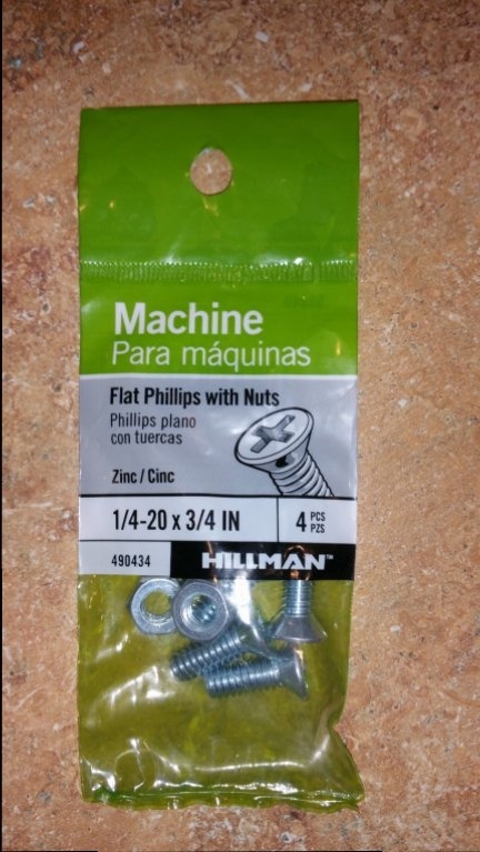

So I went to lowes last night and they had the screw I was looking for. They had one slightly longer and one slightly shorter so I got the linger one with the idea that if it doesn't hit anything on the back side, then I'm okay. In retrospect, I think the shorter on will work too and will get those to avoid cutting any bolts. Here is a picture of what I am talking about incase anyoneugh ever need to replace these screws:
The other package is a half inch and I will probably go back and get those. Hopefully this will help someone.
I am also finding the same thing when shopping to replace Mopar fasteners, they frequently are an odd length. The store inventories are either too short or too long to make a perfect match.
