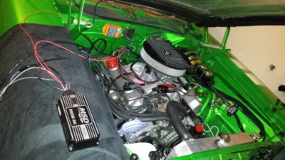

Last update: fixed the problem, and relieved that the coil is fine. Attached is photo of the MSD setup in "test mode". Now that it's fixed I'll tidy up the wires into harnesses etc. and mount the MSD box somewhere. Obviously the orange box was pooched, which vindicates Don Frelier's opinion in this thread. "Replacing one thing at a time" also proved the coil was still viable (for the moment). Thanks everyone for their input!
