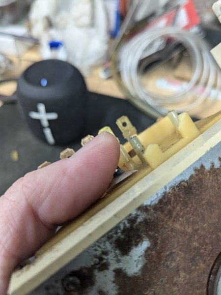

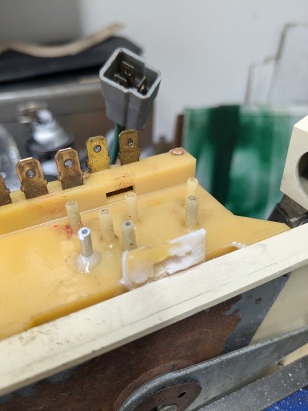

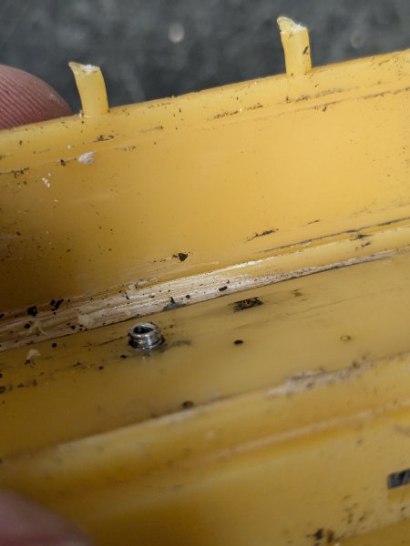

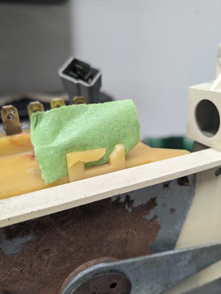

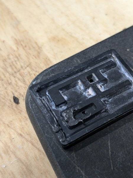

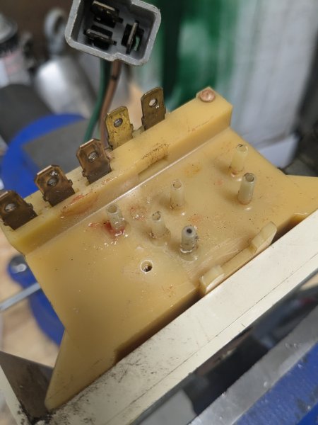

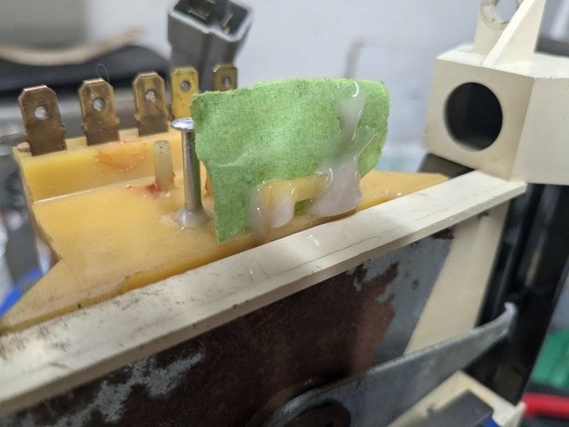

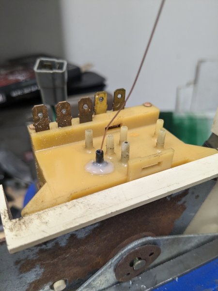

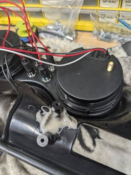

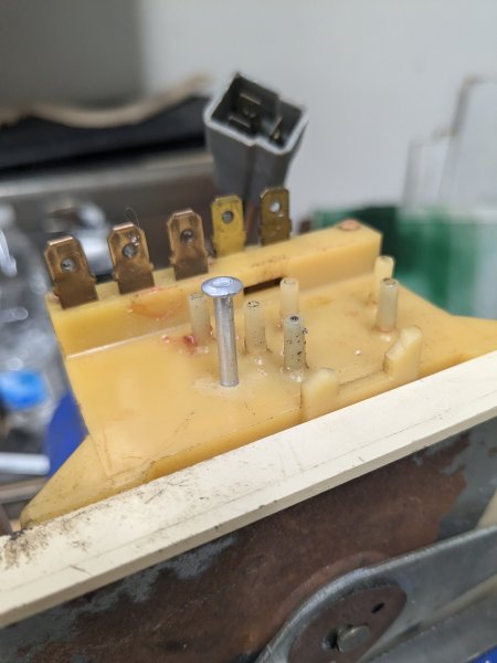

JB weld typically does not adhere well to plastic especially smooth plastic. A better choice (IMO) is 2 part epoxy however both will work if you really rough up the plastic. What I have done is use an old soldering iron to basically stipple the plastic where I indent to put the epoxy or the JB weld. Also I roughen up the "nipple" so that the glue has something to hold onto.So the bezel fix worked great. Unfortunately the pop rivet did not. First time I drove it I noticed the problem was back. I can see that the JB weld has detached from the plastic so the vacuum leak is back. The pop rivet barrel I used was very short. I've seen some guys thread them and screw them into the manifold. I would need a barrel about twice as long though to make that work. So I guess I'll have to tear it all out and try again.
I considered that. Worth a shot. I cleaned the affected area with denatured alcohol and put some on. I'll give it 24 hours before I test it.A dab of Permatex should take care of it.
