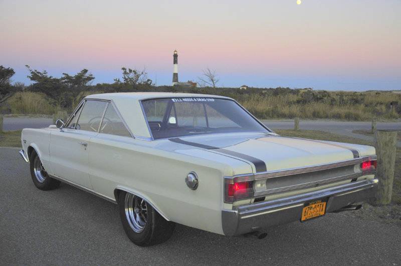

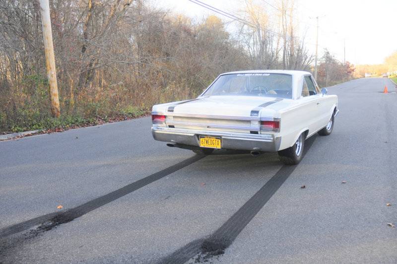

I'M RUNNING 727 MILD STALL,(200 RPM ABOVE STOCK) 3:23, 255 X 60 15 MICKEY THOMPSON DRAG RADIALS ON A MAGNUM 500 RIM WITH 4 1/2" BACK SPACE THIS TIRE FITS AND HOOKS. FOR STREET/ STRIP THESE TIRES ARE PERFECT
