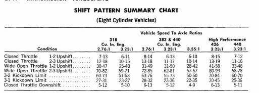

Here's a pic of the shift points from the '70 Plymouth FSM.
Your mileage may vary, depending on whether someone has put a shift kit in and what your gear ratio is. The B&M kit will raise shift points as much as 50% under light throttle (depending on how much you grind off the throttle valve). Other kits do the same. Seems like you're in the ballpark though. If you want to raise the shift points, call up A&A transmission for a governor or shift kit.
With my tweaked B&M install, I originally got 1-2 at ~15-20 mph and 2-3 at 25-30 mph (closed throttle). I've since turned that down a bit, but I'm still not 100% happy with it.
