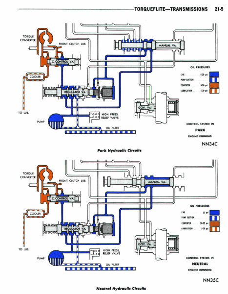

Yes, but the pressure goes from 5psi in Park to 55psi in Neutral. That's why you check fluid in Neutral, when it's actually being pumped.
The point in question was whether or not there was fluid being pumped in park vs. neutral. The answer is both, between 5-30 psi in park and 55 psi in neutral, both following the same basic circuit paths.
They are basically identical. The line and converter pressures are higher in neutral.
Yes, because of different circuits.
The circuits themselves remain the same.

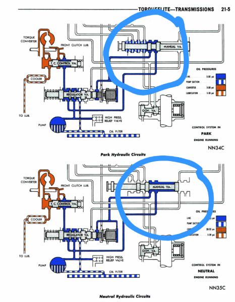

If you note that the slide valve is in a different position, and then look at the legend to see that the pressures are lower in park...
Hard to read, but in Park the converter pressure is 5-30 while in neutral it is 30-55. If it happens to be at the low end (5psi) in park, that's where your slow fill will come from.
Correct, there's no need to have full converter pressure in park with no load. I have a 68 & 69 fsm with the same diagrams.
It probably had something to do with the circuitry design and manual valve configuration?

It seems it pumps just enough for lubrication. I know my one car with the problem sits in park for a bit, then doesn't move when I stick it in drive, so I put it in neutral for five to ten seconds, and off I go.
Unless you want to refill a drained converter. Why is there full converter pressure in neutral?
It's a lot safer to get an accurate reading in neutral vs. having it in reverse or drive.
