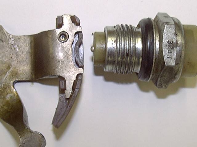

Tell me more about this "Plastic Wiper" in the transmission? If I remove the NSS can I see it thru the hole? Thx for the response.
The '69-later shifter detent inside the transmission (often called a rooster comb) has a plastic wiper that operates the NSS, if it is damaged it could prevent the NSS from working properly. Yes, you can see it through the hole.
