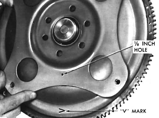

Also need to get back into my 727 handbook. Kinda recall seeing something about the centering dowel on the converters, that go into the rear of the crank. Wasn't sure on the 2 years I'm working with, or if there are two sizes on that dowel.

Here ya go
Oh, yeah! Thanks, ZombiePopper! Learning real quick that there's a wealth of info, and knowledge here, and great folks to deal with. Old dog can learn.
