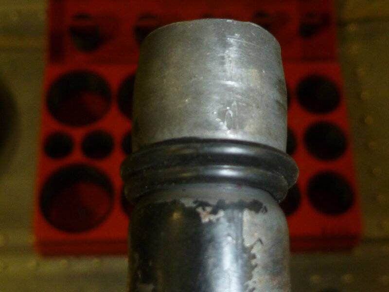

Does anyone have the specs for a dipstick tube o-ring. Doesn't seem to be available as that part from the autoparts and I don't have time to order one online. If it is a standard o-ring size and material I may be able to get from grainger next day. Thanks.
hardware stores sell o-rings take your ds tube and fit one. Could measure od of tube at o-ring depression and buy one with the same id. Plumbing supply also has o-rings.
Yeah, I think someone who input those numbers was smoking the wacky tabacky....
3/4" OD is probably right 5/16" ID no, don't think so...
FWIW every time I've tried a standard O ring it's leaked... They are a slightly odd size..

I was going to say, check the area where the "O" rings go into the tube. I had a tube that was cracked in that area. Some Mopar AFT RTV sealed it as i didn't have another tube at the time.
TF O RING SIZES (OD X thickness)
Dipstick tube .750" X .100"
Speedometer Adapter '66-on 1.750" X .100
Speedometer cable trans end '60-'65 .950" X .100"
Shift cable '60-'65 .700 X .100"
Park cable '62-'65 .437" X .070"
Early NSS ?-'65 .970" X .100"
Rear band lever pivot shaft '66-on .625" X .062"
Iron TF pre-'59 Shift Cable .500" X .062"
Thanks for all the input. I don’t have a leak (yet), just a tube with no o-ring as I am putting things together. Great info, Thanks again.
