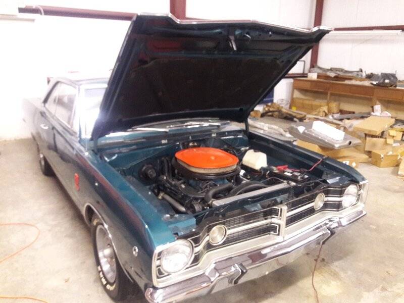

We used transmission blankets in the day, and didn't give a crap. Junk yard transmissions 30-50 bucks then. Engines 100-125 and we are racing the next day. It's a wonder that we find matching numbers machines today. If you are going to play, pull your matching numbers stuff and go with a play engine and transmission. I have a 400 based 451 stroker, and Hughes built transmission in my 68 Dart GTS. The matching 383 engine is tucked safely away. I never had the matching transmission so that is that. View attachment 1004160

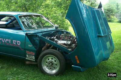

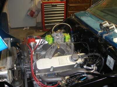

Did that myself. My one 727 auto. '74 Duster. 451. I redid engine. Ditched the 452 heads (That performed well for their times.) for Brodex B1/BS heads. New rods/pistons. New custom grind Comp cam (Mechanical flat lifters) Compression went from 10.5:1 pump gas to 12.4:1 E-85 fuel. By estimates went from 500+ horse to 600+ horse. 727 has bolt in sprag with Kevlar bands. Rear 8 3/4" Mosier 40 spline axles with spool. And what did I forget? DRIVESHAFT! The car was snorting mad and ready to put down a possible sub 10 sec run. Let the two step button go at amber? And the driveshaft exploded so fast the car didn't move. (Thus exploded before line clocks let go.)
Moral of the story? Im still the weak link!
