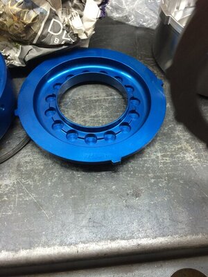

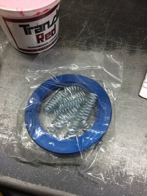

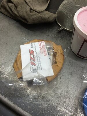

View attachment 1005895 View attachment 1005896 View attachment 1005897
