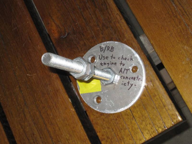

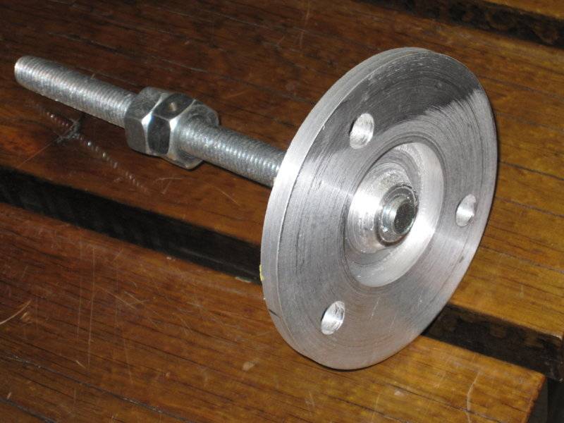

You need the case totally empty so you can work through the bottom to read a dial indicator fastened to a adapter bolted to the crank flange. Rotate the crank and read the indicator at every 90* interval. Then you can determine if the engine and transmission center lines are matched up. I used dowel pins from McRobb to correct my alignment. I'll try to remember to get a photo of the adapter tomorrow.

Mike493 I'd find where its farthest off center and closest to center. I'll post how bellhousings are done just the hole is bigger.

Here are a couple of photos of the adapter I made to mount my dial indicator to the crank flange.
