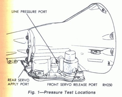

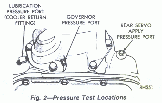

1st I have to say I'm not a big tranny guy, just a gearhead/racer...LOL...., Is it a manual Valve body or Auto ??, do you have the Throttle Pressure Valve linkage, still hooked up & adjusted properly ??, if it's auto shift still, possibly 1st/reverse band out of adjustment, loose not keeping in 1st gear long enough, pull pan & readjust, or possibly the second gear band too tight/out of adjustment, out side of the main body, easy to get too & adjust/check, they will shift so quick, if it's not a manual valve body {especially with rear band apply type, to save the overrunning clutch from granading, for full manual}, you wouldn't hardly know it shifts, from 1st to second, if it's auto mode & the TPV is not on &/or adjusted correctly... What kind of fluid are you using ??, what kind of line pressure ??, do you have a trans-cooler or at least looped the line so it can circulate properly ??, I highly suggest a quality high flow trans filter & checking the line pressures & a quality trans cooler/heat sink, of proper size/flow for your intended use, heat is the enemy for sure, maybe the wrong length transmission gear shifter linkage for your particular brand/style of shifter, they are sensitive in adjustment, for sure....There is a great book on the subject of Torqueflites... "Torqueflite A-727 Transmission Handbook" HPBOOKS-1399 Munroe author, I highly suggest purchasing it, great information for modifications on Torqueflites....
