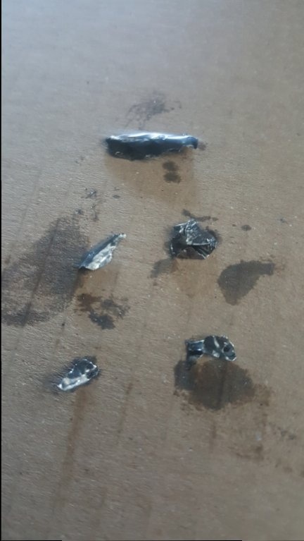

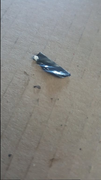

Pulled the pan today, thin metal in the pan.

Could be a few things but I suspect planetary teeth or case. That kind of goes along with your description in the first post. Is it magnetic?
Well doesn't look like brass, time for the trans to come out. What caused it is the major question!
Looks like low roller clutch (sprag) springs. Are they barely magnetic? If so that's them. Need a close up pic. But wait until it comes apart. Like I said earlier the problem will show itself.
Doug
dvw is right, the sprag springs are quite thin metal. They're accordion shaped before getting ruined.

Yep, that sucks. Gotta pull the transmission. The sprag is in the very back of the case so everything has to come off, which is good because you need to inspect everything.
Standard bolt in sprags are no different than the stock press in unit so no advantage......unless the case fits loose. Then it helps to keep it solid. A&A transmission sells an ultimate bolt in sprag which has a few more rollers over stock. This is an upgrade part.

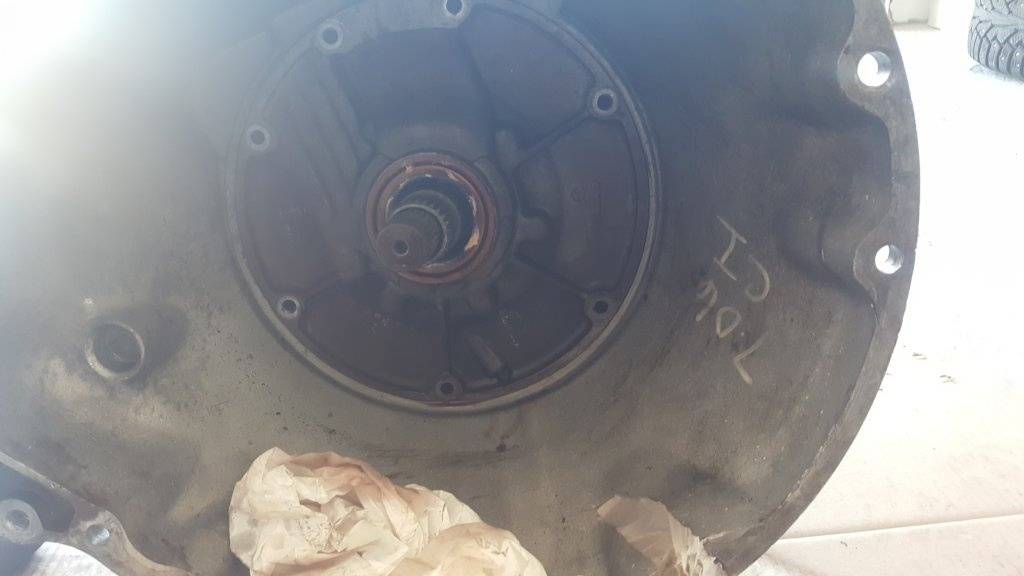

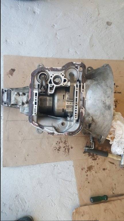

Tranny is out, what is the next step to get it apart.
