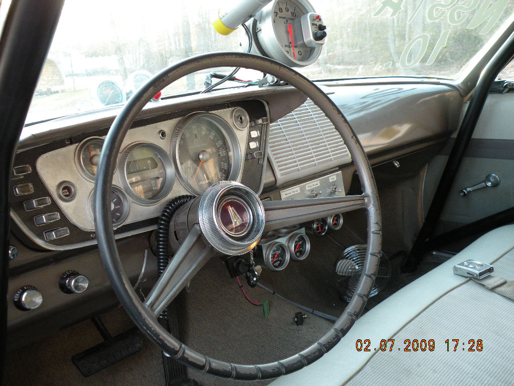

drop the pan and make sure your dial is adjusted correctly. make sure when you put the car in nuetral, your detent is right on the nuetral safety switch. if your off a little, youll get what your saying .slippage.
turn outside dial till your on nuetral correctly, then push all your buttons and go back to nuetral and see if its still in the center. adjust if necessary.then do it again.
