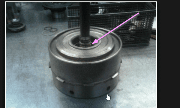

im sitting the pump on the output shaft (picture attached)
i sit the assembly like in the picture on a table then place the pump on top and try to spin the pump. theres quite a bit of drag on the bushing.

Lift the front drum off the rear, then set the pump on the front drum (bushing and hub lubricated properly. Does that turn easily? If that's okay move the pump over and slide it over the input shaft and let it sit down all the way against the rear clutch.. Does it turn easily on there? This will tell you which part it's tight on, inner or outer area of the hub. Make sure you're seal rings are locked and didn't get damaged.

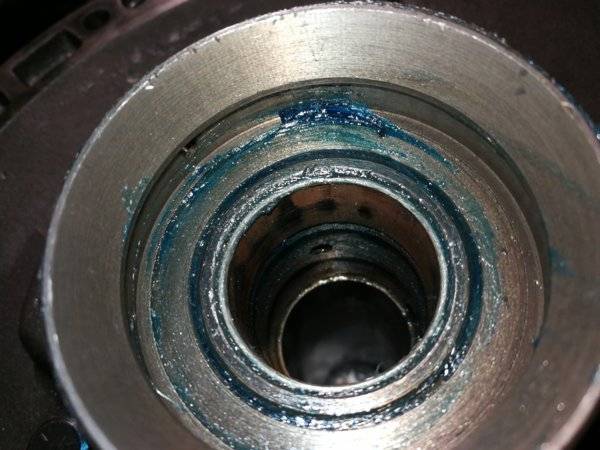

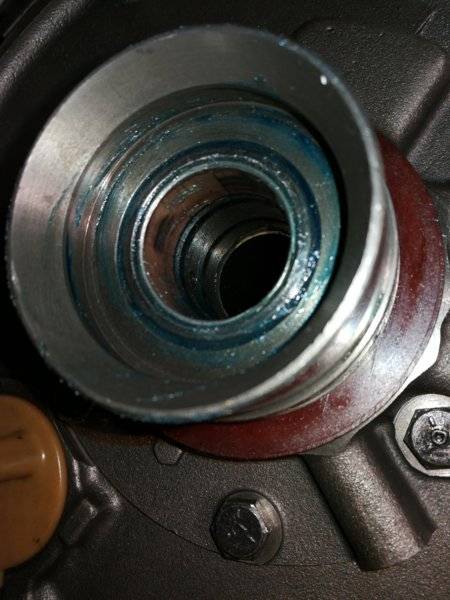

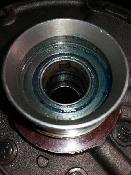

i took some pictures of the bushing you can see the black parts i guess where it was wearing out from me trying to turn it several times
Yes, those are your high spot. Notice how they are in a line on one side. Bushing got a little cockeyed going in. I'd be inclined to put a new one in. Use an appropriate driver and a press. The proper driver is stepped so that a portion goes inside the bushing with little play. The step that sits on the end of the bushing, where the force goes, is parallel to the business end of the driver so that when it's in the press everything stays square. Very difficult to get them in properly with a hammer.

It is straight, now. It got cockeyed going in, right where those marks are all in a line. It straightened out after that, but the damage was done.
