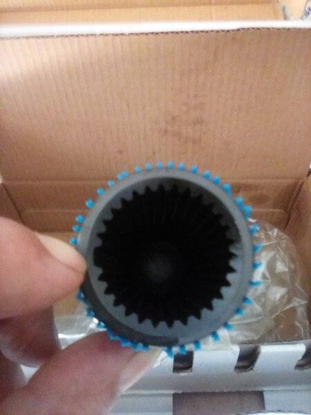

Can anyone tell me if there is a 727 w/30 splines ever come with a keyed spline on the output shaft?
I purchased a billet steel shaft yoke with 1350 u joints and the yoke has a keyed groove...all of my spline on my tail shaft are symmetrical ( un-clocked)...IIRC my trans is a 69
Thanks
Basically that is a vent to relieve pressure from the sliding action as the suspension moves up and down. Early 727s had a seal on the output shaft and a vent hole in the rear of the yoke to relieve pressure. That style required manually greasing the splines in the yoke as no ATF could reach them.

Can not get into align,, love's the shaft and yoke...had about .0005 clearance +/-
