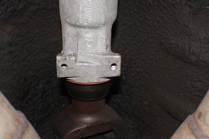

727 tail shaft threaded holes?

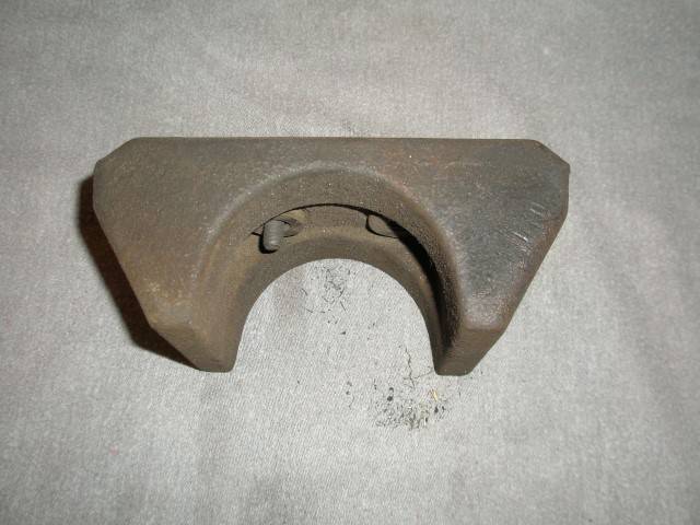

What mounts here?
Cross member is attached and more forward.
A big *** weight to dampen vibrations.
(One of these things)
Mostly found in C bodies. I think trucks too.
Nope, Never did figure why it was on some cars and not all.
