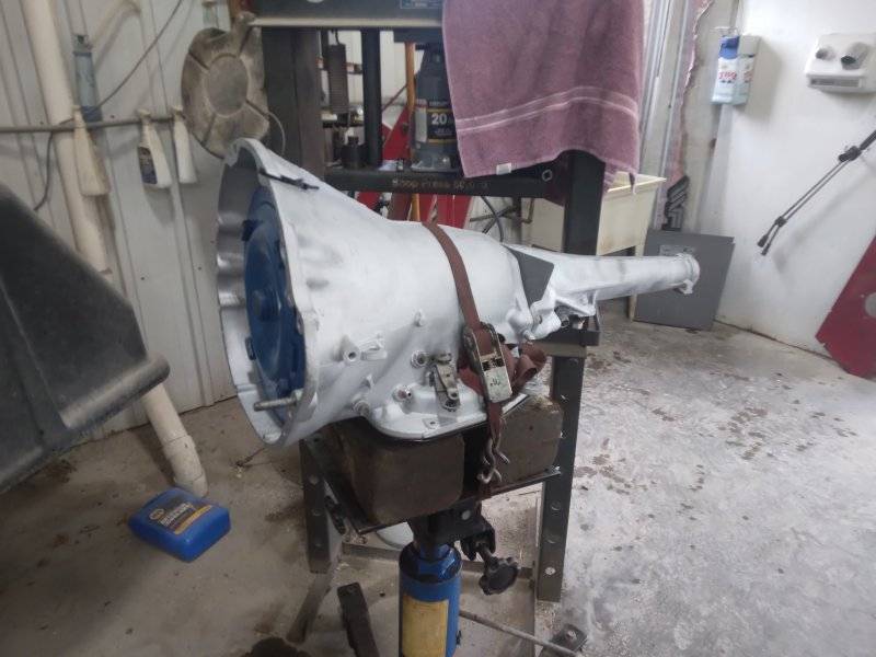

I recently removed my transmission and got it rebuilt was test driving today and attempted a hard acceleration from 65mph, the car then lurched tires screeched then shut off, I coasted to the side of the road placed it in park and restarted I appears to be driving fine shifts from 1-2 &2-3 just fine but I am wondering if the kickdown is missadjusted and kicked me I to reverse? Do I just need to adjust that or do I possibly have another issue. I have a 440 with a holley 750 and an Edelbrock RPM intake factory kickdown linkage I adjusted so it works the way it is shown in the video (I believe) I will recheck the adjustments tomorrow, but any advice would be greatly appreciated.
