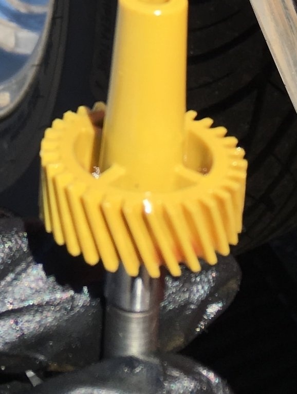

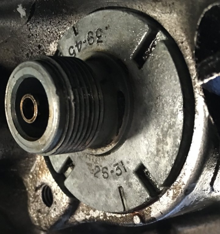

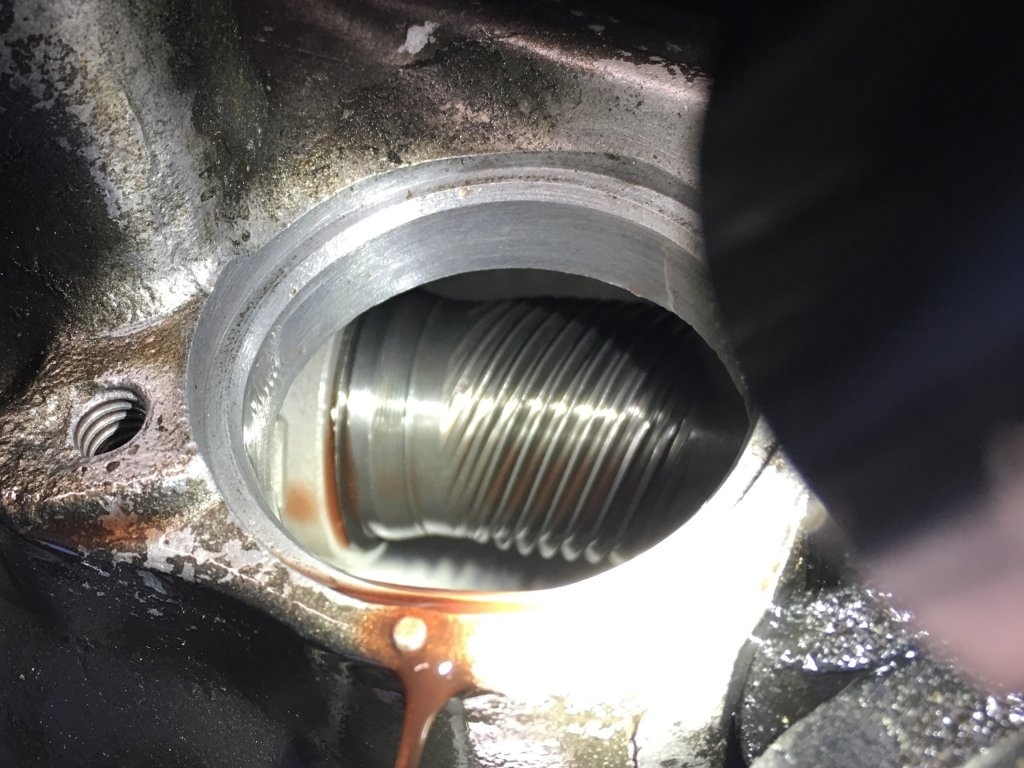

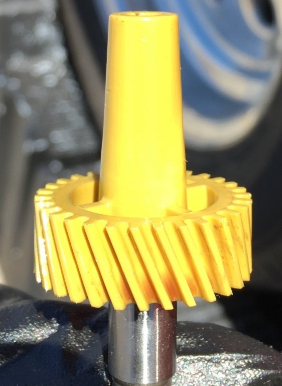

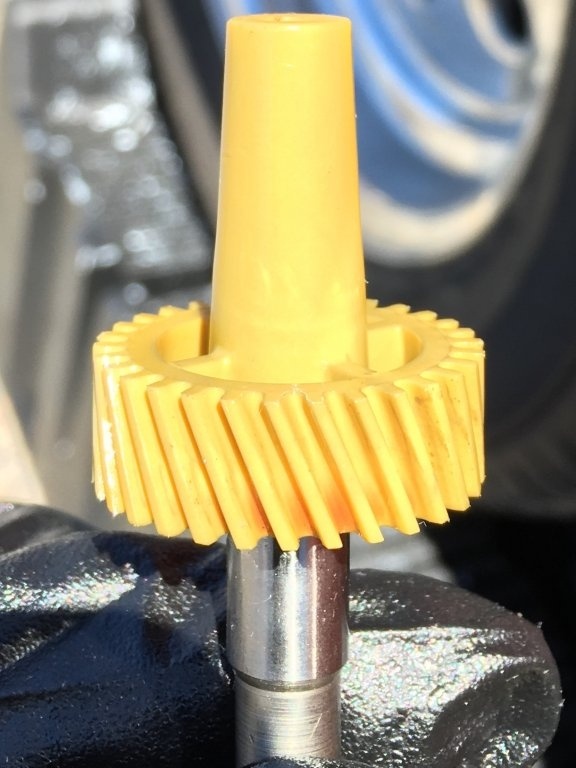

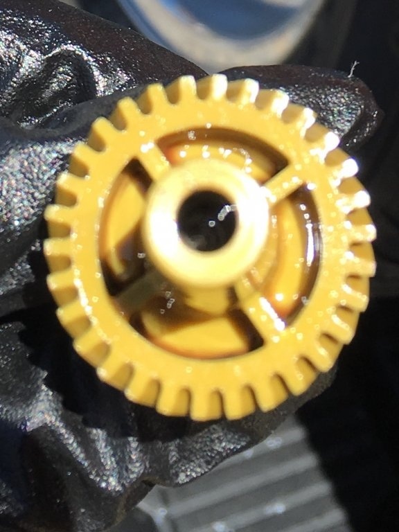

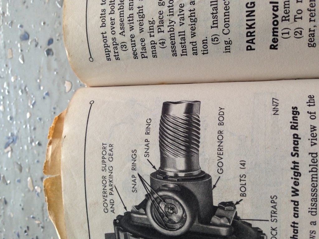

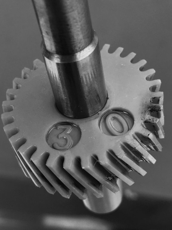

So I got under the car again this afternoon to try to get some more info on this speedo gear mystery.
The facts of the case are these... The speedo gear has 30 teeth, is yellow, is in perfect condition, and not stripped in any way. The gear does not spin freely while installed in the housing and housing installed the 26-31 position at 6 o'clock. The speedometer needle bounces a sweep when the housing, gear, and cable are all assembled together. These are the facts of the case, and they are undisputed....
Is it even possible that the pinion or gear in the trans isn't spinning? I wasn't in a position to rotate the rear wheels to see if it spun in the trans.

B-II the "gear" on the output shaft is 'cut' in there, it has to turn if the shaft is turning. Does the car move when you put in gear? A little play on words- "A FEW Good Men" might be needed here,lol.It looks like everything is installed perfectly by ur pics.
Lol I love it! Very good catch Ol'Bee brother! I wondered if anyone would pick up on that quote! So yes I figured as much with that gear being cut in as I looked at it. And yes the car does drive when out into gear. I don't know where else to look for the issue. And I'm tired of draining and filling my trans just to poke around in that stupid hole!
