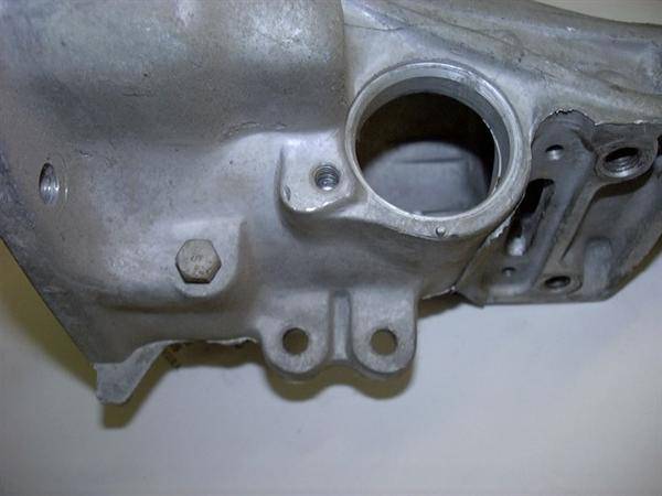

Some truck 727's didn't have the two bumps on the bottom of the tail for the floor shift bracket. If it's going in a column shift car, no worry.
