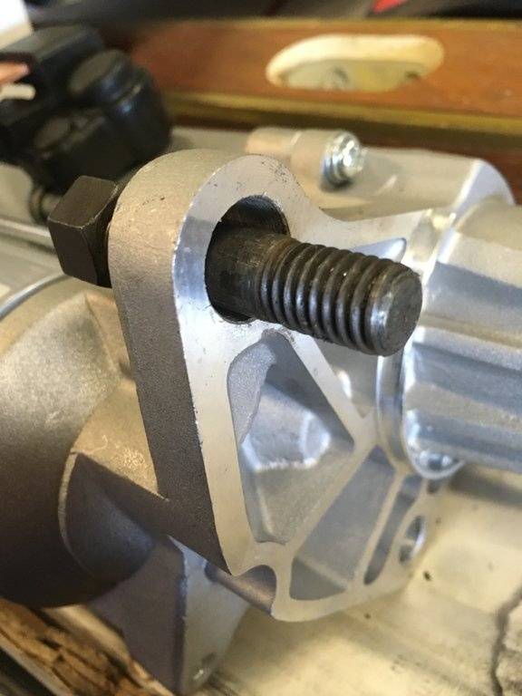

Is there supposed to be a shim on the top hole of the starter were the stud goes?
The starter stud goes on the bottom, it is 7/16" X 2". The top of the starter takes a 7/16"-14 X 1 1/2" bolt.
