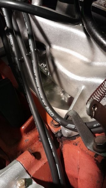

I tried the MSD street fire wires to replace the yellow Accel wires. Noticeable difference immediately. Under $100 (2yrs ago), can't remember if they were cut to fit or not but that's easy anyway

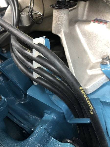

I’m running the old firecore 250 wires 8 mm. Had to enlarge a bit the looms.

I used the FireCore 8.8mm factory cut length. Used a Dremel to widen the plastic mounting tabs.
