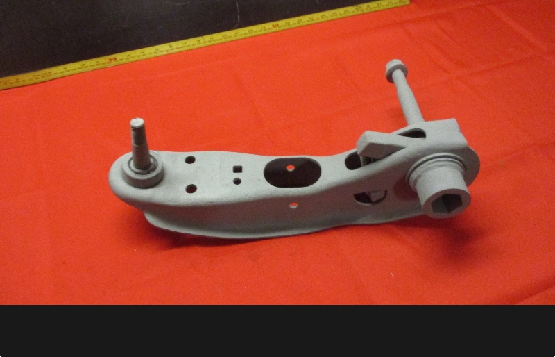

No front. Similar to a 72 but apparently different. This a 72.
This is what they look like for 73/74

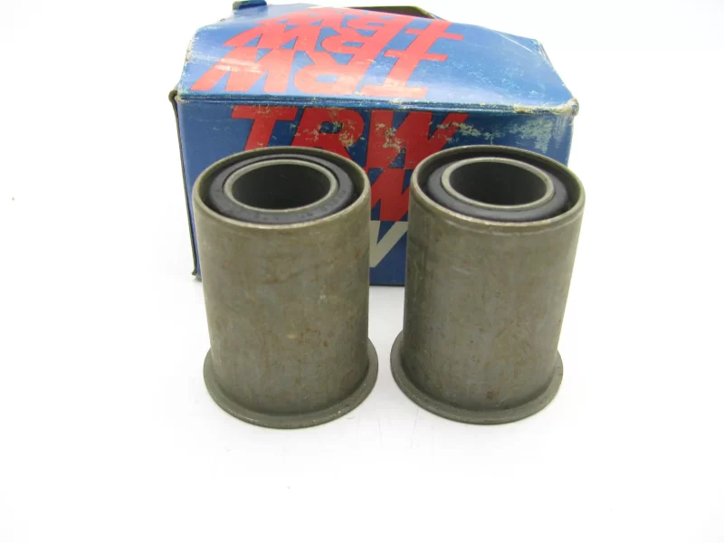

You mentioned years but not model of car. For Chargers, 73-76 takes the same bushing number. #12316 TRW from the catalog I have. As far as the control arm itself, I would imagine it is the same but I can't say for sure. You would have to go to My Mopar and download a parts book to check that.
Hey. That looks like the right bushing.

70-72 and 73-74 do take a different bushing in the Satellite/ Road Runner models.
