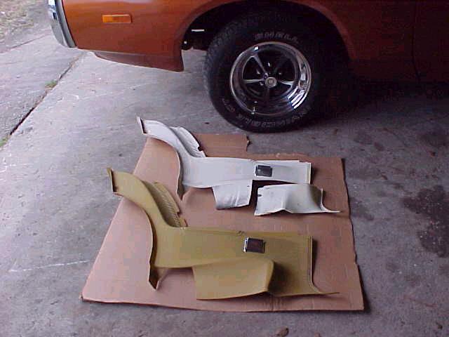

The rear lower quarter panel covers are different also. The 73's are one piece while the 74's are two piece to accommodate the shoulder belt retractor.

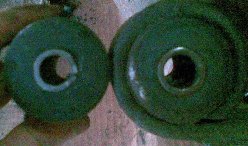

true forgot that!, ALTHOUTH lot of ppl claims 74s got elongated front eye bushings, my 74 got same round front eye bushing with just a THICKER ISOLATOR BUSHING, using an smaller hole for the bolt, smaller bolt thickness and of course diff hanger with just the smaller hole difference to match the bolt assembly
Pic attached showing the minimal diff on bushing thickness and isolation I found but still being round eye, smaller inner diameter but same outer diameter... sorry the bad quality pic, cheap cell phone back in the days. Mounted earliers once by mistake, then I found the one what matches my 74 hanger and bolt, ( left one ) and replaced.
already stated on first as rear panel defference for seatbelt assembly.
here the pic showing this:

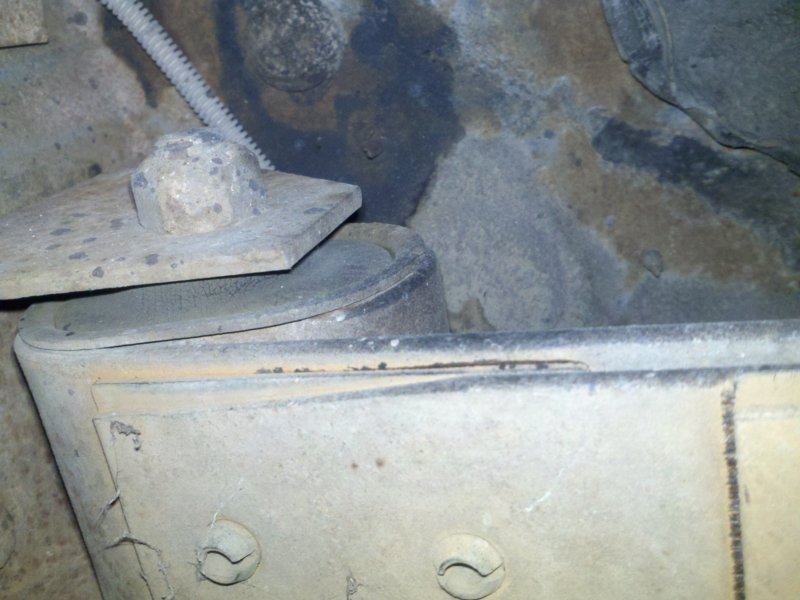

Her is a pic of the front spring eye bushing from my 74 Road Runner. I purchased the car in 1977. It was built in Dec of 73. The rear springs as far as I can tell are original and untouched. You can clearly see it is oval.
yeap I know... always have known that, but however I'm showing what I got... true my car was assemblied in Venezuela not in USA and exported BUT using same USA specs and castings. Maybe is about build date ? dunno.
Fortunatelly my car got round eye kind, available around easier ( bushings and springs itself ).
strange that 74 Plymouth would use an elongated front spring eye. my 74 charger is round, built nov 9 73. maybe the leaf pack had something to with it? I have 7 on both sides.
I'm looking into the parts book numbers for the rear spring options. So far, as far as my Road Runner is concerned all the numbers check out. The rear springs are called out on the build sheet. Do you have a copy of the build sheet for your Charger? If so look at line 5 second block series over from the left and you'll see "Rear Springs" with Lt. and Rt. below. The last three numbers of the production spring assembly will be listed here.
The Road Runners are probably easier to figure out as they all had the same series code "RM". The Chargers could be several different series codes, "WH, WL, WM, WP, etc." Then you have to know the body type, 21, 23 etc.
There is a list of the production springs and the corresponding service spring numbers in the parts book. The number you will find on the broadcast sheet is the production spring number not what you'd order for a replacement. If you can post or PM me the number on your broadcast sheet I can give you the service number, how many leaves were in the pack, and if it was a standard or heavy duty spring set.
