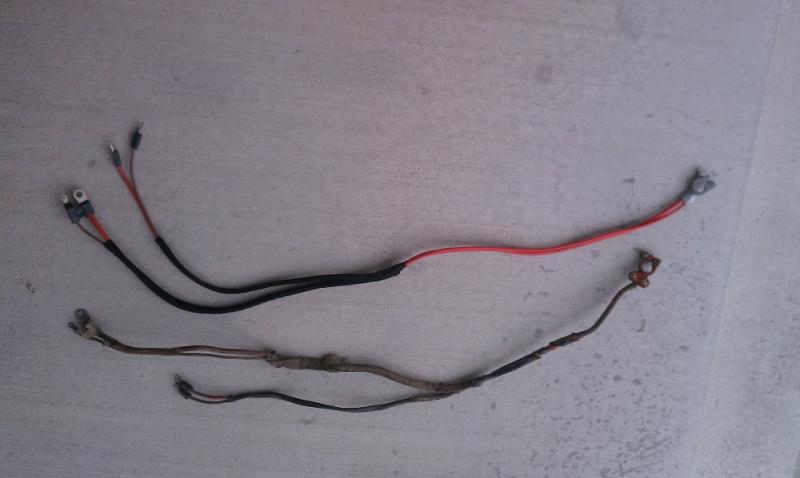

So, I have been looking for a new positive battery/starter cable, got to looking around on fleay bay and whatnot and found a bunch of cables that said they were for small block Mopar b-body or 71-74 small block b-body, but they look nothing like the one off of my car. So then I came across a cable that looks exactly like mine, correct wire color, ends, etc, but everywhere I find one, it says its for a 68-70 big block b-body.
So, my question, does anyone else with 73/74 Roadrunner or Satellite small block have a battery/starter cable that looks like this?
Would like to know as its possible someone could have changed the relay and cable back in the day.

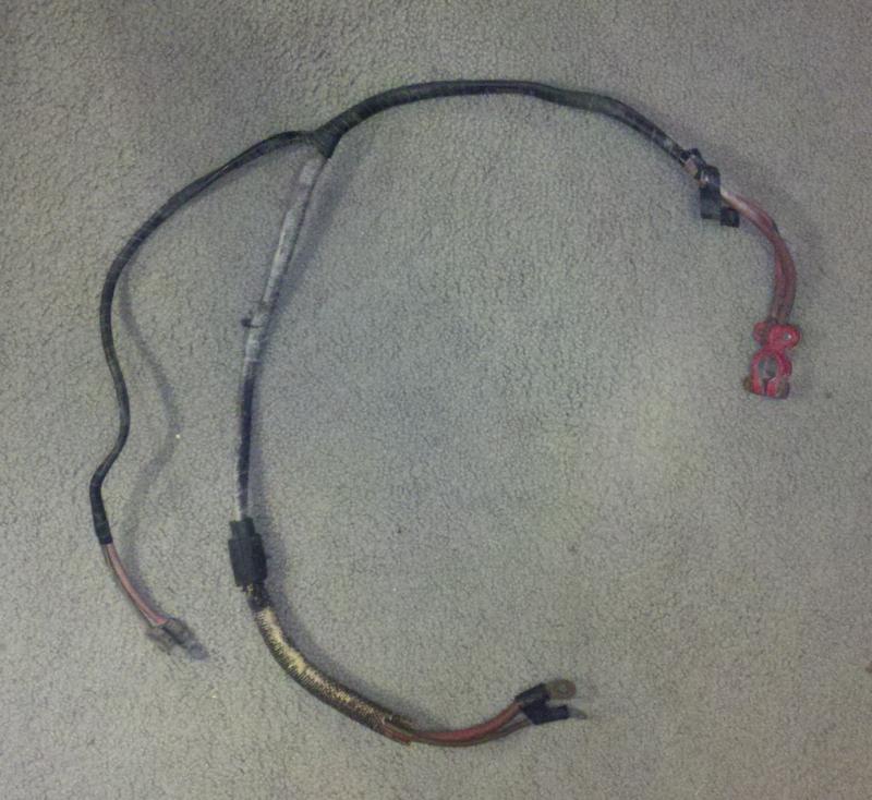

Im away from home right now, but it looks the same as the cable off of my 74 satellite with a 318. Ill be back in a day or two and i can take a picture then.
That looks like the ones I've seen. Here is a pic of the battery cable out of my 74 Road Runner.

Thanks for posting, so I was right and the clown that didn't want to sell me one lost a sale!!! Good!
Those took a special cable because the relay is mounted on the firewall. So the wires to it are extra long. Some folks repop them noe but they are way expensive. I bought a 37 incher from Roseville and extended the relay wires. Inlinf solder connection covered whit heat shrink insulstion then wrapped in cloth tape. Looks original and about 40-50 bucks rather than 250$

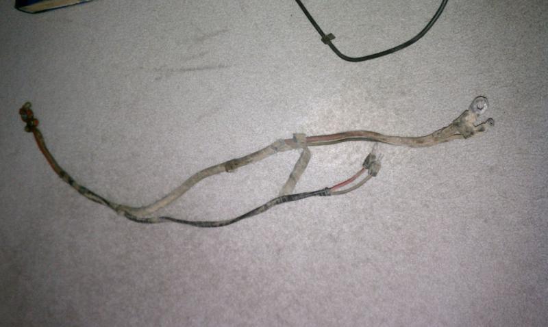

I found one that is this layout, 43" length, and only 45 bucks. Appears its made by Goodmark, but I don't know how the quality is yet, will know when it arrives in a few days.
Hey, would you mind posting of pic of that cable when it does arrive. I'd like to see what it looks like and how it measures out as well.
Here is the cable I got today, its longer then my original, however, the terminal side to the battery was hacked shorter decades ago because the wires were trashed and corroded. Did a dry fit, and should be good. Will know for certain once the motor is in, but I don't see any issues reaching the starter, and the cable is a bit longer to the relay on the firewall, however, that's good, as it will now route better.

I got one of the short ones and made it work but it really is too short. Thought about the earlier big block and now see it is a direct equal to my small block.... Which actually makes sense since they both have the starter in the same place.
