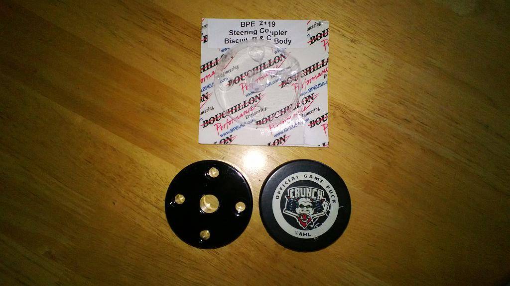

I just got one from Bouchillon last summer. It basically is a hockey puck, powder coated but hey, I had to have it.
Here is what was left of mine and the new piece. Your call if you want to try the puck but I have to say the new one is nice. No longer requires the heat shield BTW.

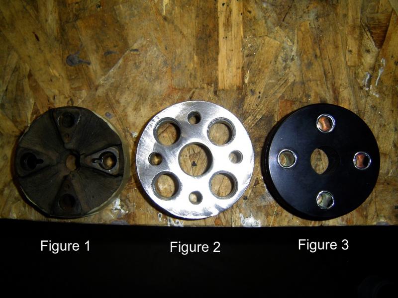

Funny your bring this up, I posted a thread about this last year, because I made one out of steel and one out of a hockey puck. I am using the steel one now in the car with the headers, and it only cost me 34 bucks to make. The hockey puck one I made cost under 10 bucks, but my hockey puck on has metal sleeves in it. And yes, hockey puck is the same diameter as the original rubber ones.
Here is a photo of the original, steel, and hockey puck ones I made.

That one doesn't look quite as thick. Wonder if it will work.

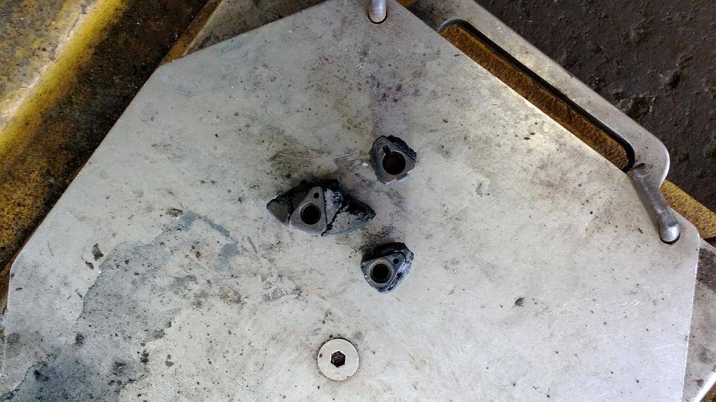

I've had no luck besides the solid one , I am going to attempt to cast a 'new' one using materials I ordered today and re-using the original steel inserts , I will update this thread as to the attempt
I saved my old inserts. Don't know why, just did as that was all that was left.
I have them somewhere in my pile of stuff here.

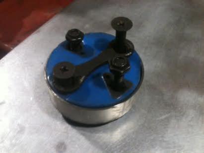

I made this part using the original lugs , the material is a high heat resistant silicone rubber , with a steel outer ring , I made a mold out of steel with dowels to locate the lugs into position while I pour the silicone mix , it takes a few hours to cure.
I have new allen socket bolts coming so I can re assemble to test the prototype ...

well , the silicone media turns out to be too soft , I used the most firm grade of silicone and without the steel ring it wont last long. It should work as well as the original without the ring or I am calling it a failure. I am considering using a polyurethane and giving it another try since I have the mold. I tried silicone first because of the location next to the header tube - but i've read that polyurethane is not very heat tolerant ( fishy smell when heated ? )

If you are referring to the steel one I made, it was just a standard round stock I got from a local metal supply shop here locally, no lathe required, just a good drill press.
