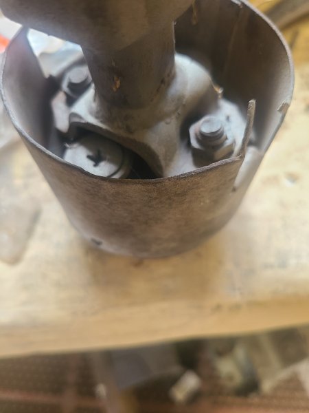

After getting my 73 roadrunner steering column 90% completed, I'm still not sure how to handle the rubber hockey puck" for the rag joint
Has anyone had any luck finding it or a viable solution for this?
