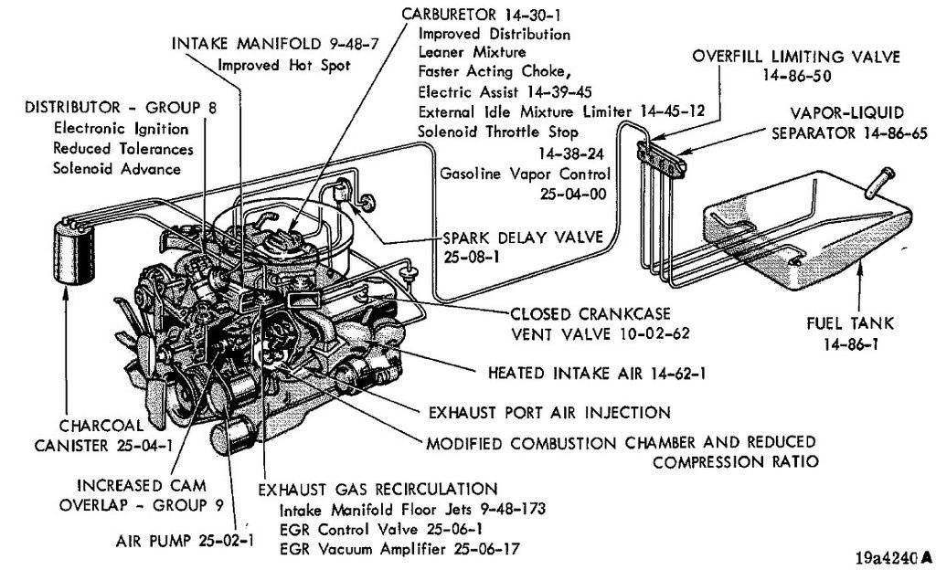

I just deleted the charcoal filter. The tank vents to the four to one tank thing, then vents to a 1/4 hose that runs to the rear of the car. I did not reinstall the hard vacuum line from the tank. The purge input is plugged at the carb.
If you want to keep it, I think you find a line that only draws a vacuum above idle.
To function correctly, the three-nipple canister needs to be paired with a carburetor having a balanced timed port above the throttle plates designed for the purge function. Without that, it may be easier to locate a ’72 four-nipple canister, can then tee into the PCV and vacuum advance lines as designed for ’72 application.
Like a dummy, I didn't take pics of mine.
Anyone got a diagram, or better yet pics?
Right now the big line from the tank is straight into the carb at the accell pump.
