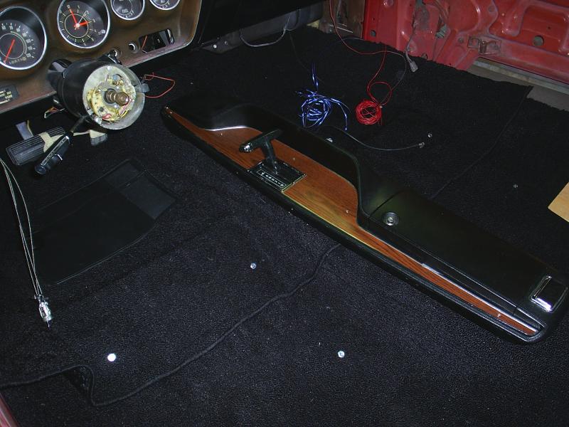

Been there, done that fellas. The 73 has the rag joint as well as the steering coupler. Unbolting the column from the dash will let it drop about an inch. It needs to unbolted from the firewall.
AND be sure to put a towel over the column when you slide out the cluster or you'll be painting that as well.
Here is a pic where you can clearly see the column unbolted from the dash but bolted to the firewall. Drops about an inch.
But, another option might be to just unbolt from the dash and pull the wheel ... that may work.
I have to agree with ODZ, I have a 74 and it is a very tight fit as the column does not drop much if the rag joint is tight I unbolted at the firewall to get more room to work. more room = good
