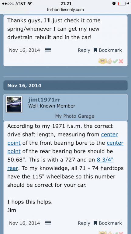

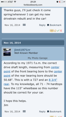

Ok I have a 73 charger original 318/904 car that currently has a big block kmember with a 440/727 8 3/4 reared that's a couple weeks old. I am trying to find a driveshaft for it and didn't know if anyone knows a part# and length of the driveshaft I need? or even a line where to buy one?
I used this old post
