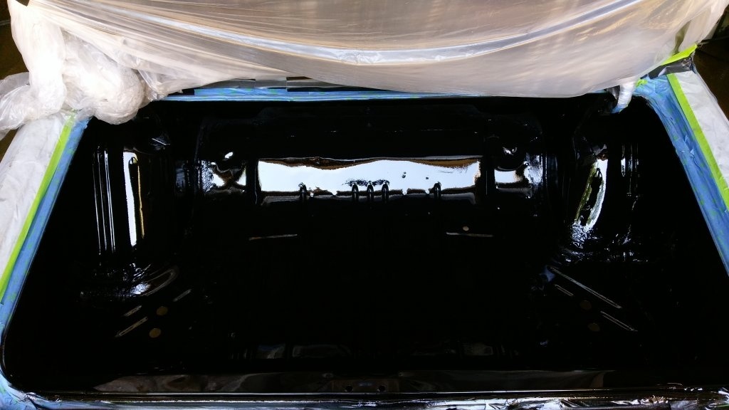

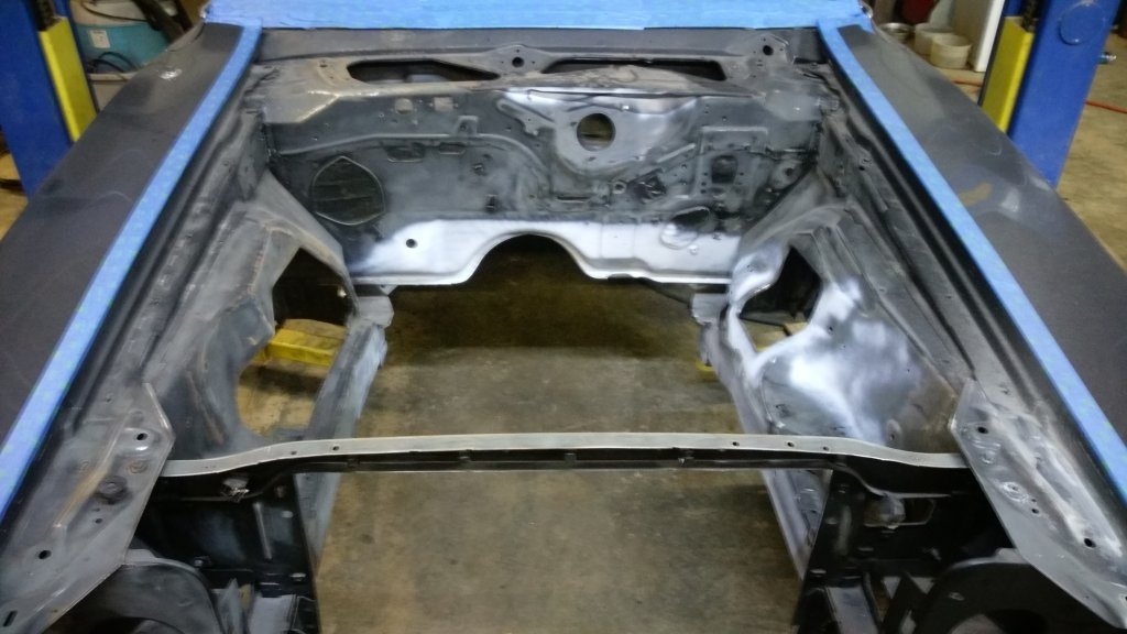

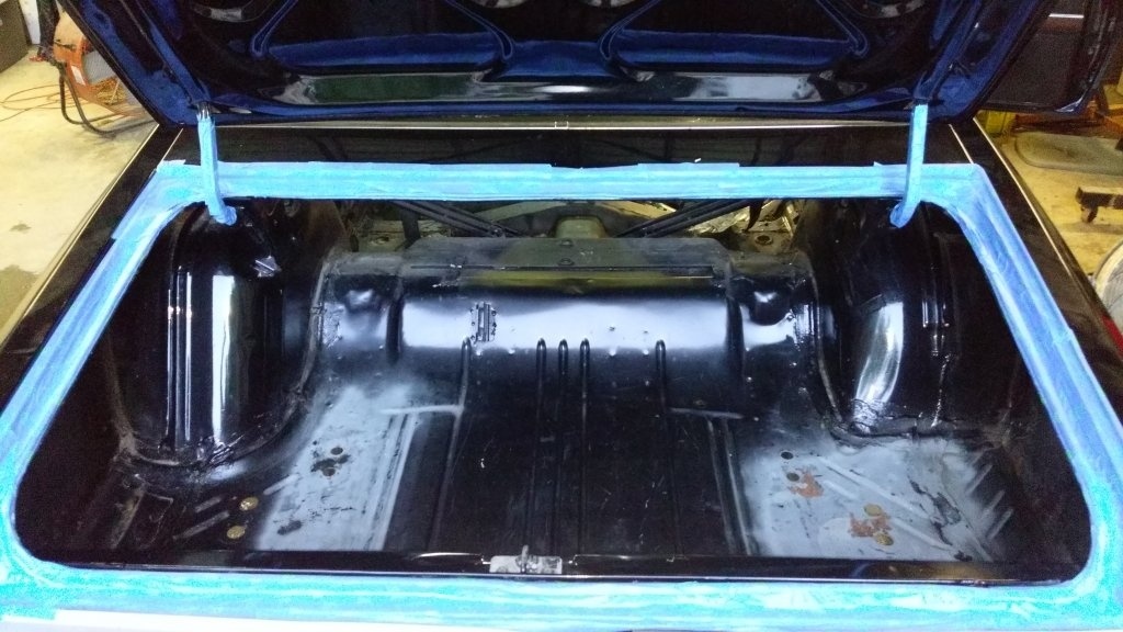

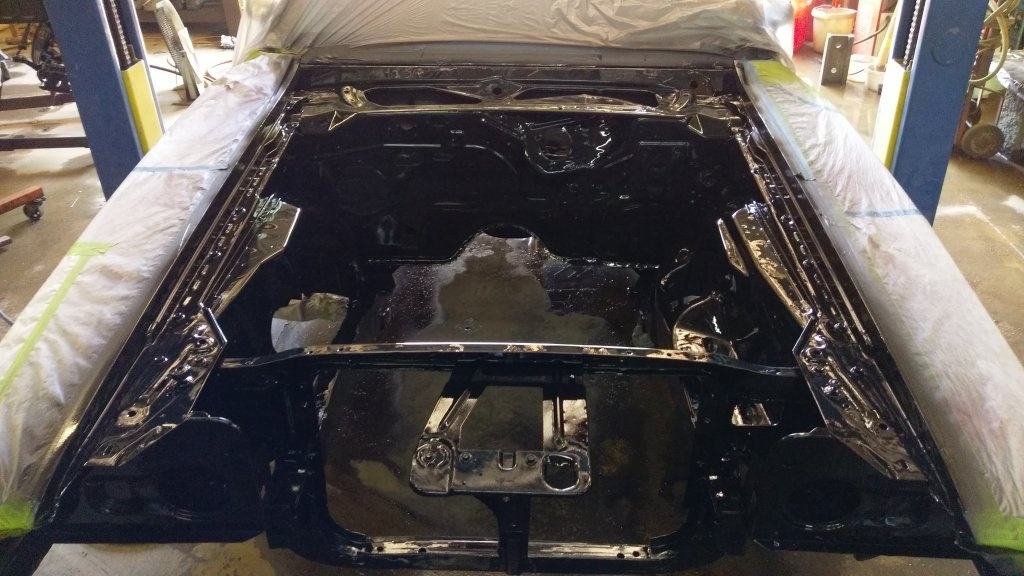

Finally got the trunk, engine bay, and under body painted:

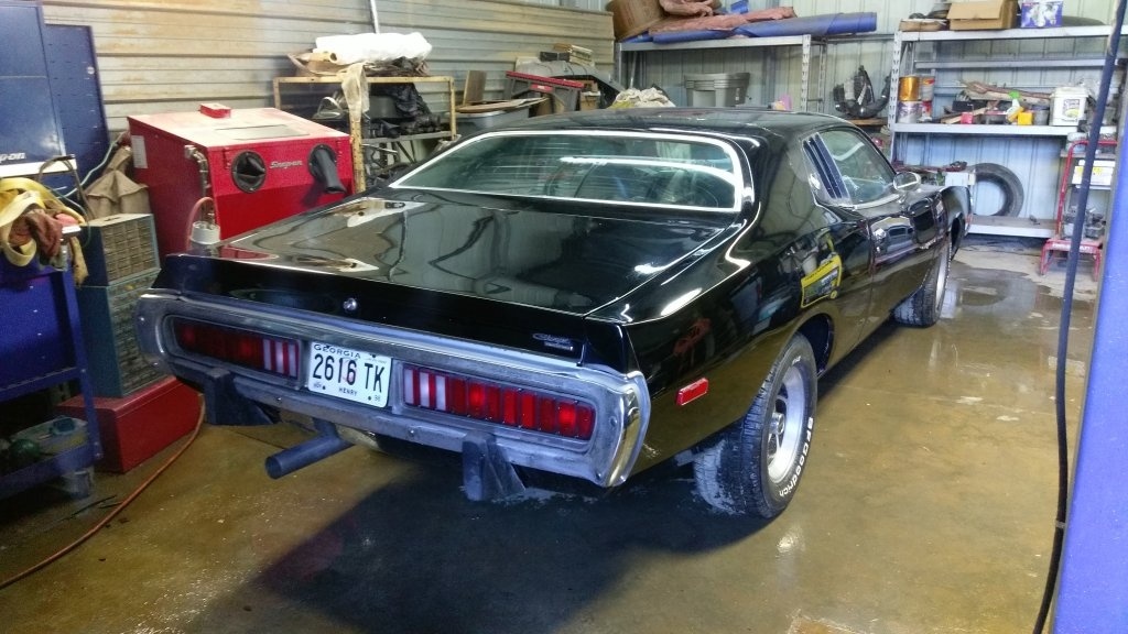

Before and after of trunk:

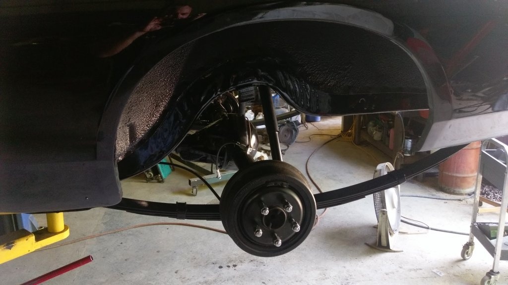

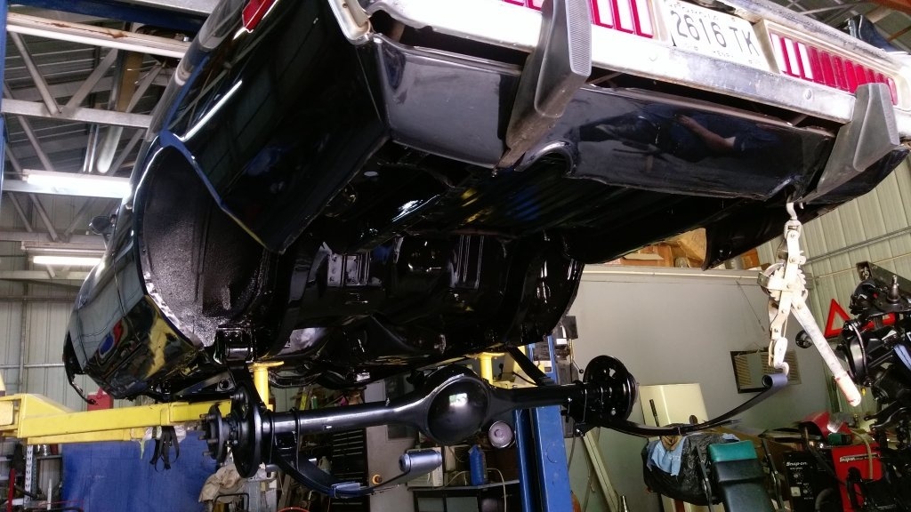

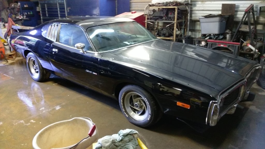

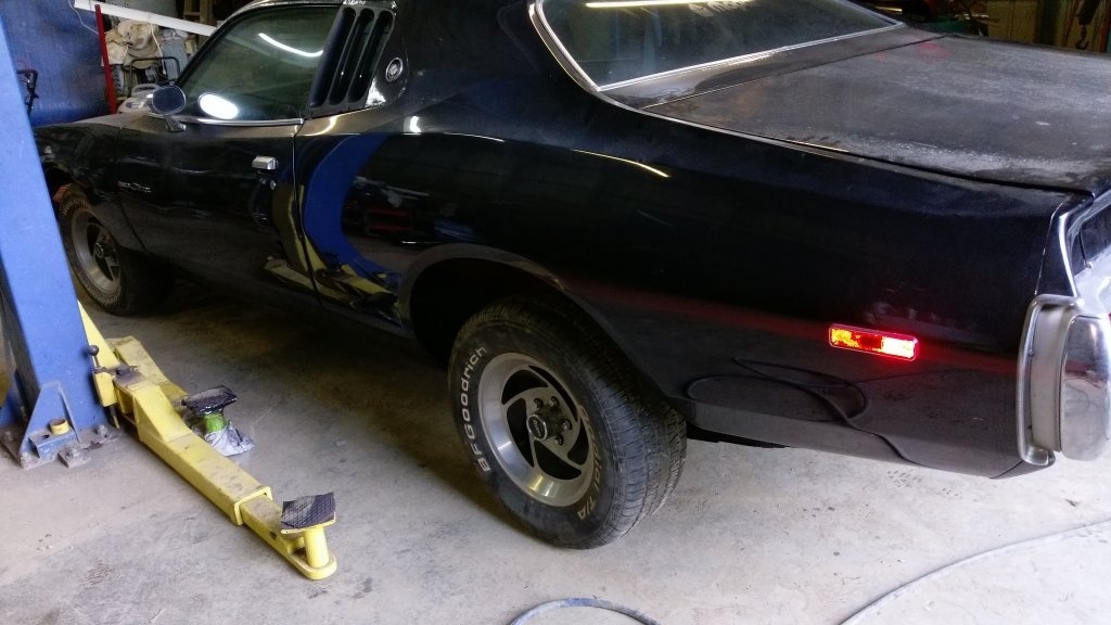

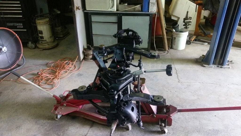

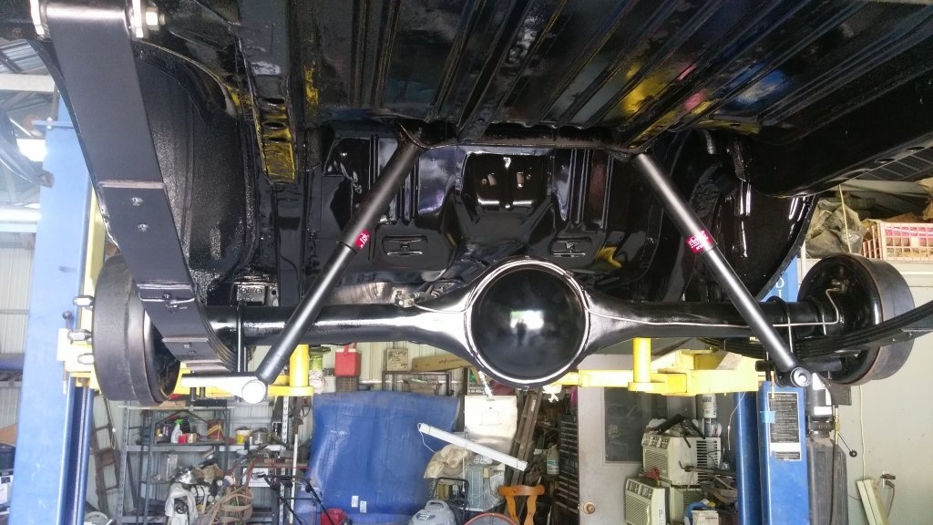

The rear end is sky high after removing the ISO clamp. I have 2" lowering blocks for the rear until I can order custom rear springs. Also note, the factory rear sway bar wouldn't work after removing the rubber ISO clamps. The angle of the sway bar bracket was all wrong. I'm going to get Firm Feel swaybar once I get it on the road.

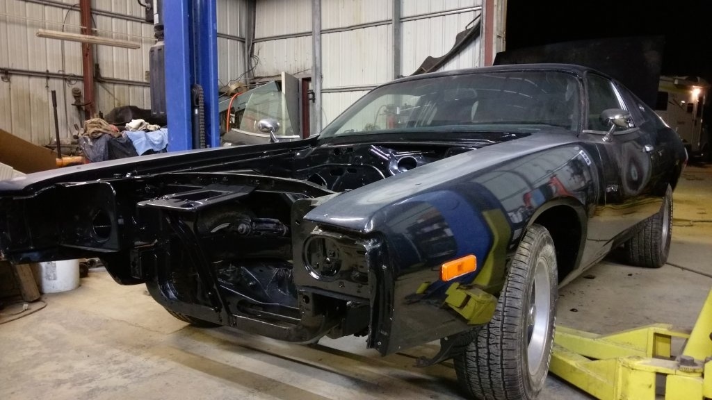

  • My dad put the front bumper on the car; it looks like a car again! Yippe!

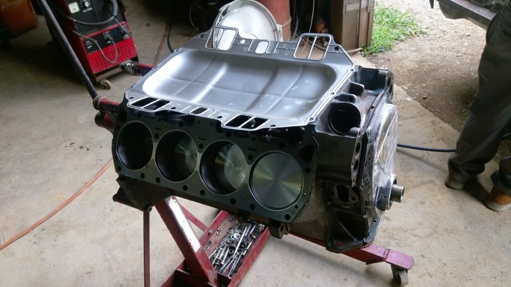

The bad: The rear cam bearing is fitting too tight for my dad's likings. He's hoping the local machine shop will help him fix it.

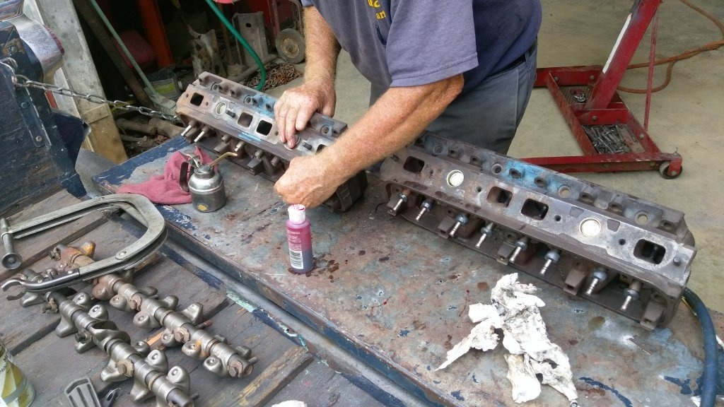

Engine coming together. It is a 383 bored 30 over. Compression is right around 9:1. Mild cam. Should be a nice driver. The heads are stock 452 castings that came off the 400.

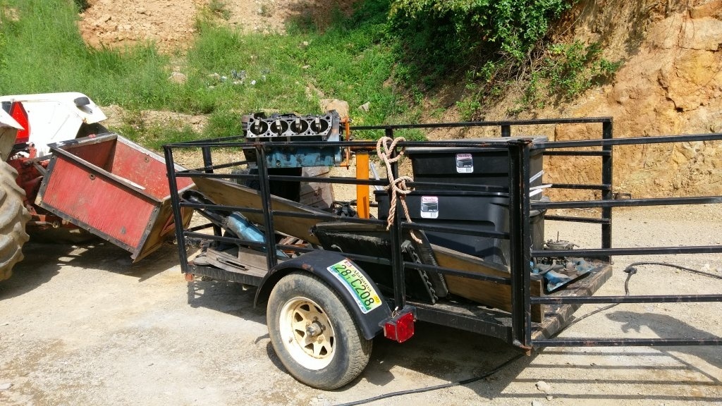

Trailer full of spare parts. My dad put the parts (except the block) in a old mini-van like any proper Alabama natives would do, lol. The block is the original 400. One day, in the distant future, I hope to build it to a 512ci 650 HP stroker with a 5 speed manual.

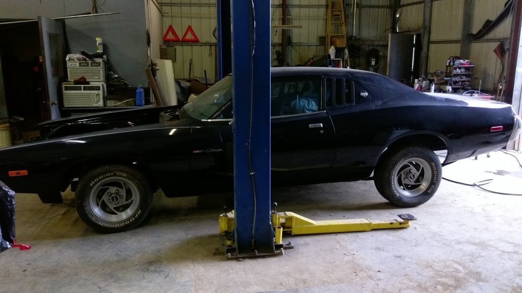

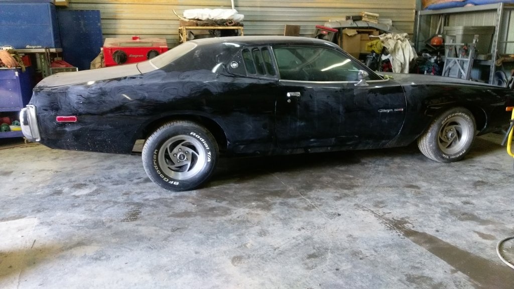

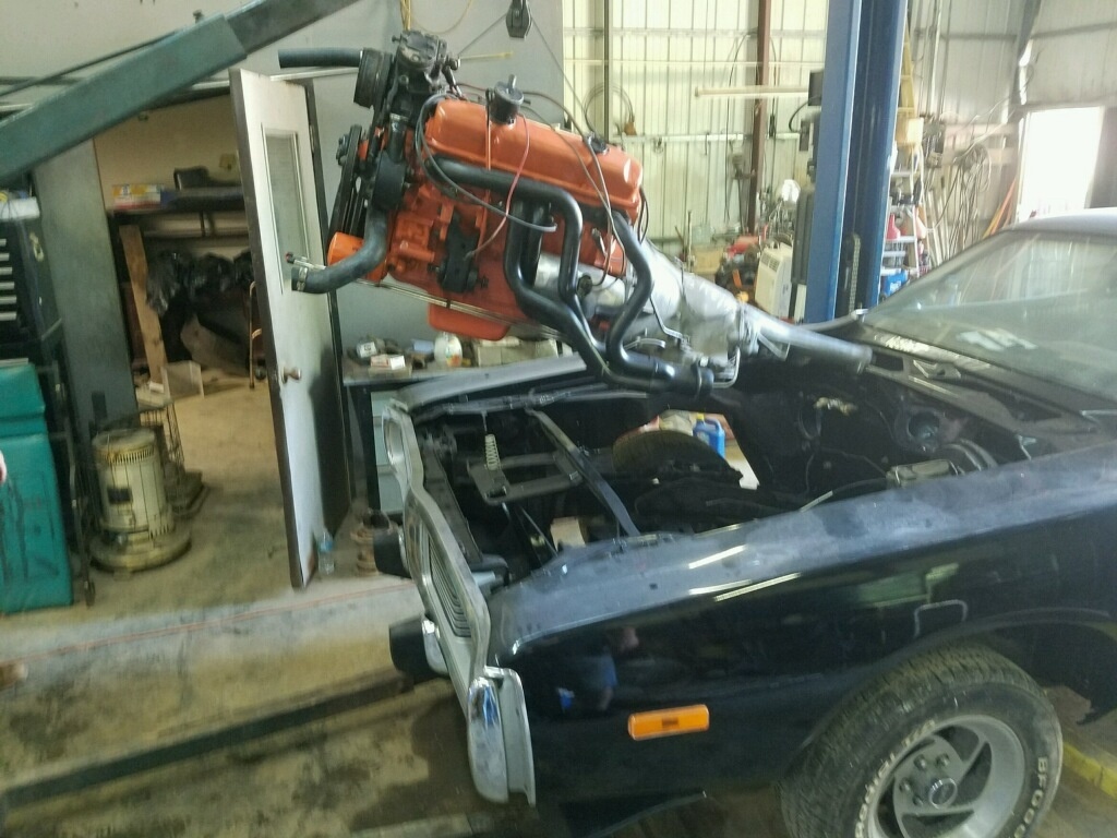

I really like how the car sits with the engine and transmission in it. Not too high, not too low. My friend took some pictures of the engine going into the car as my phone was dead. I'll post them when he sends them to me.

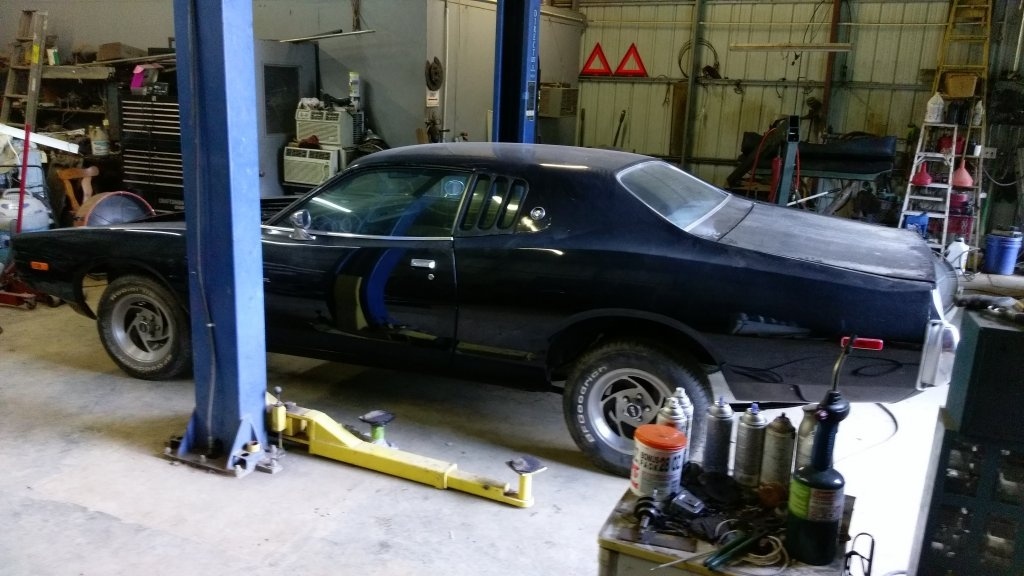

Yes, the car needs a bath but my dad thinks the wax adds a layer of protection. Whatever, we'll finish the polishing the paint then put a car cover over it when I go over there September 10th.

Here's the engine going on August 20th. Those headman headers were a breeze to install. We did have to remove the right side header to swing the engine around power steering box, but it was easy to install.
