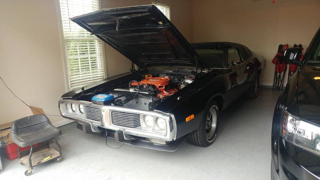

Got the Charger home on Saturday. Still needs a list of parts and work before it's read for the road.
The cars still needs:
  • Carburetor hard fuel line
  • Front to rear brake line
  • Transmission lever
  • Quieter Mufflers (The neighbor called the cops on Monday for noise. I was just driving it around the neighborhood, lol!) I'm thinking about either a pair of SUM-638253 2 chamber or adding glass packs beside the gas tank.
  • Vinyl top installed
  • And work out the electrical issues.
  • Seat covers
  • AC and heater lines, blower fan, etc

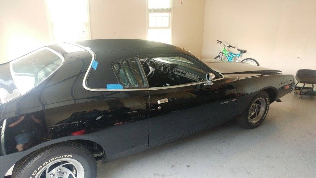

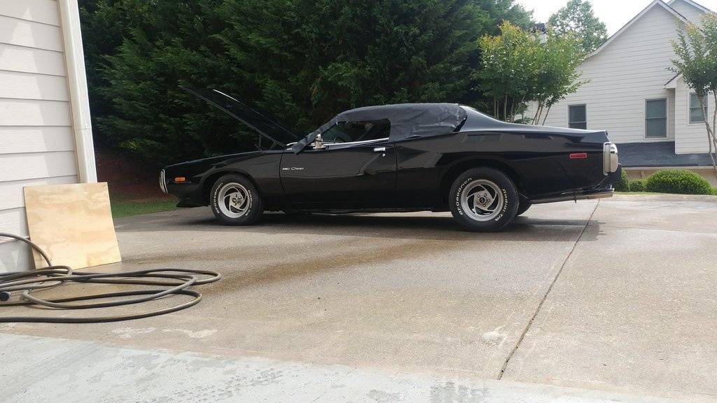

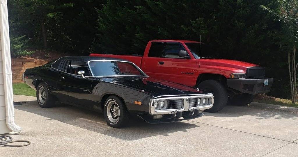

Installed the vinyl top today. I set the car outside around 10am then let it bake in the sun most of the day while I worked on small things here and there. I would rub out the wrinkles every hour or so. Damn top got so hot I thought I would need gloves handle it! I then move the car inside to install the top. My wife and I spent about 3 hours installing it. The top went on very easy with no major issue.
BTW, What do you guys think of the wheels? I bought them with the car back in '95. Not sure if I want to change them. I can't picture "MY CAR" with anything else.

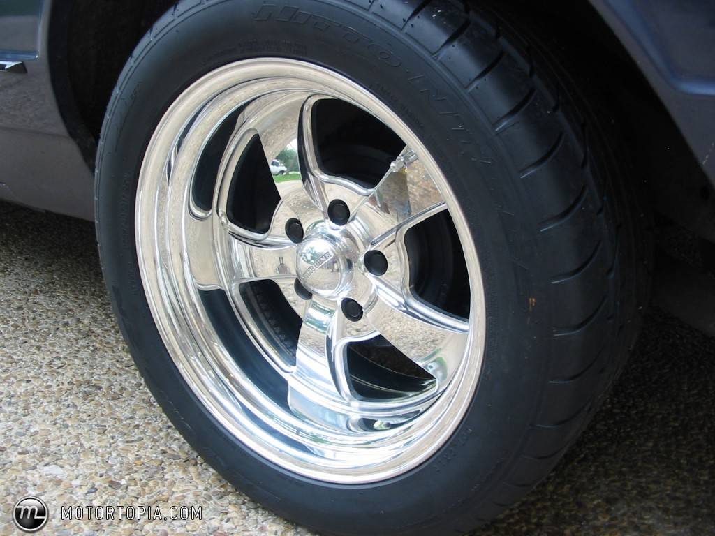

Can't go wrong with Cragar SS/Ts on a '73 SE triple black. This pic is the closest I could come up representing Cragar SS/Ts on a 73 SE triple black. Notice the '72 grilles ugh!!! I like '72 grilles, just not on a 73. And the silly side pipes. But those Cragars look good on there IMO. Not mine, random internet pic from about 15 years ago.
But it's your car, if you're set with those rims then stick with it. I like them but like the Cragars better.
