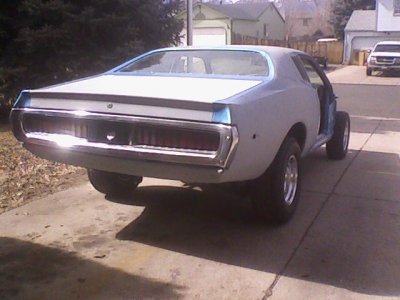

Sweet thanks! Should have mentioned I have 72 tail lights installed already!
That just makes life a little easyer for you then.

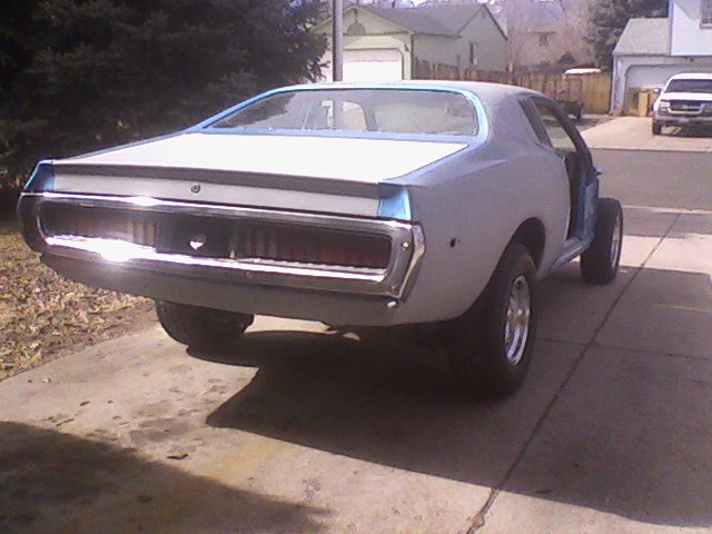

yes the 74 tail lights fit without mods
no mods ....
Is the wireing crunched up behind them? I've done 4 diff 73-74 cars s.e. and non s.e cars and non fit without causing harm to the wireing ,
I'm not saying your wrong it's interesting Chrysler had some very crudely put together cars maybe your car has a bit more room then other's. Is there anyone else that has done this with out mod of the 73-74 tail lights ? I'd like to know ,I have my 74 sunroof car I'm going to be doing the bracket swap on soon maybe I'll get lucky and this one will fit (I didn't want to mod to much on the sunroof car)

its definitely tight , but no , the wires and sockets are not crunched up, the wiring does turn down but are not pinched or folded. the housings are bolted to bumper like they are supposed to. im using the 73 74 fill tube and it fits behind the plate no sweat.
That is very interesting. On most the socket hit or have the wireing so kinked that after a week of driving there would be a problem with rub holes .
But we are talking about less then 1/4 " so it could be anything a rechromed bumper with a little more thinkness where the bracket go's or?
Well there it is it's doable on some.
one thing is of they fit comfortably and different if they fit tight... but definitelly fit
