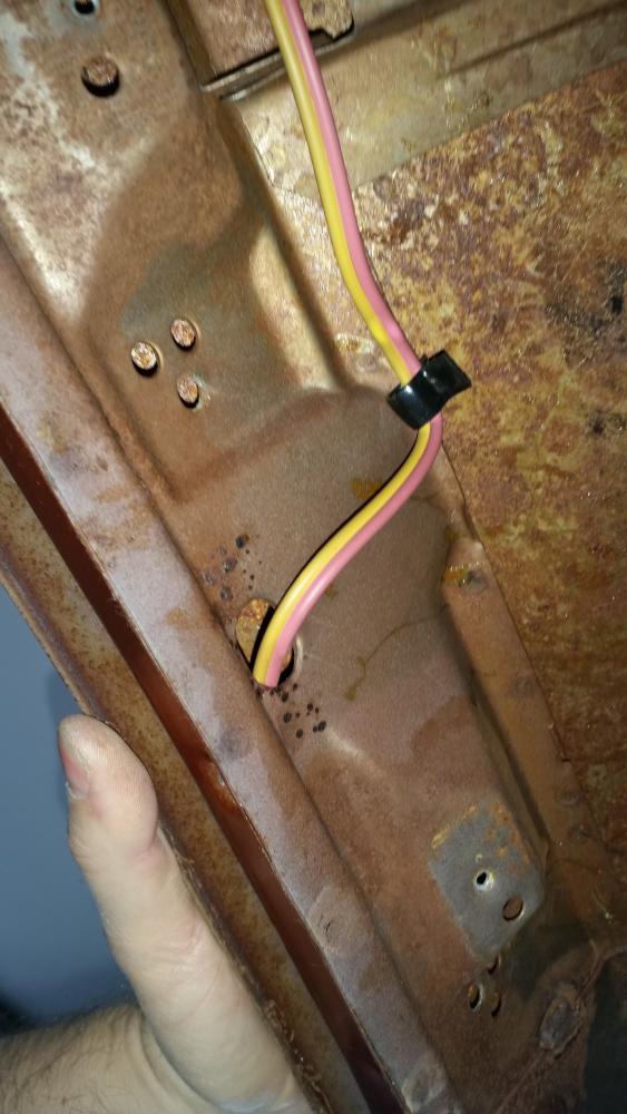

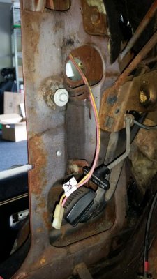

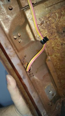

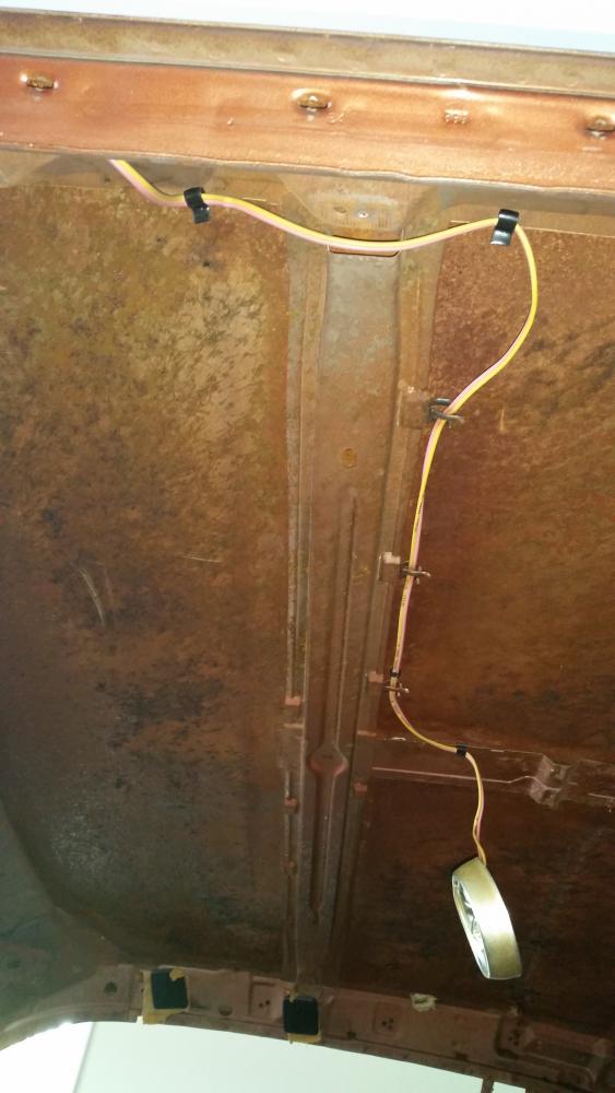

Hi
Anybody knows domelight wiring route (yellow/pink wire) is it
Goes down near to B-pillar or A-pillar. I know i can see that other wiring where that wire goes but i dont have other right now.
I don't recall exactly which is which, but (typically) the dome lite has power all the time and one of the leads goes to ground via the door jamb switch.
Hi
YOu should find a female and male connector under the dash close to the parking brake area. I'll have to recheck under mine, but If I remember right it was in that general location.
Driver side A Pillar post... up to kick panel. Plug is part of underdash harness but exactly on back of kick panel area, at a side of the rear lighting harness plug.
There is a an opening in the channel right above the driver's door that goes down the A-pillar.
This should help
Thank you all .good photos that help a lot.
